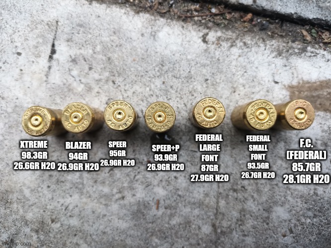

        Most, not all spp 45 brass has a thicker case head. Most, not all lpp 45 brass has larger case capacity. It's not by much.
        Case weights and H2O capacities Federal (large font) 87gr/27.9gr H2O
        Federal (small font) 93.5gr/26.7gr H2O
        FC (federal) 85.7gr/28.1gr H2O
        Speer 95gr/26.9gr H2O
        Speer +p 93.9gr/26.9gr H2O
        Blazer 94gr 26.9gr H2O
        Xtreme 98.3gr/26.6gr H2O
        The thicker head on the spp also moves the web farther up into the chamber.

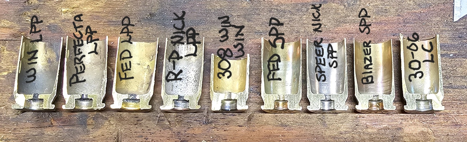

          Some pics spp 45 brass

              Here's another for ya
              You don't need to section the case, you can measure depth with your calipers from the case mouth.. Some spp case heads are thin, and have a thinner web. The F C. and federal large font brass are both like this and will expand in the web .005 beyond what the other spp cases will with 45 super loads.
              Lpp winchester, r-p and federal will also expand .005 in the web beyond the spp cases, but I got a deal on lpp Barnes +p brass that does not. Which is weird because I think Remington makes their brass.
