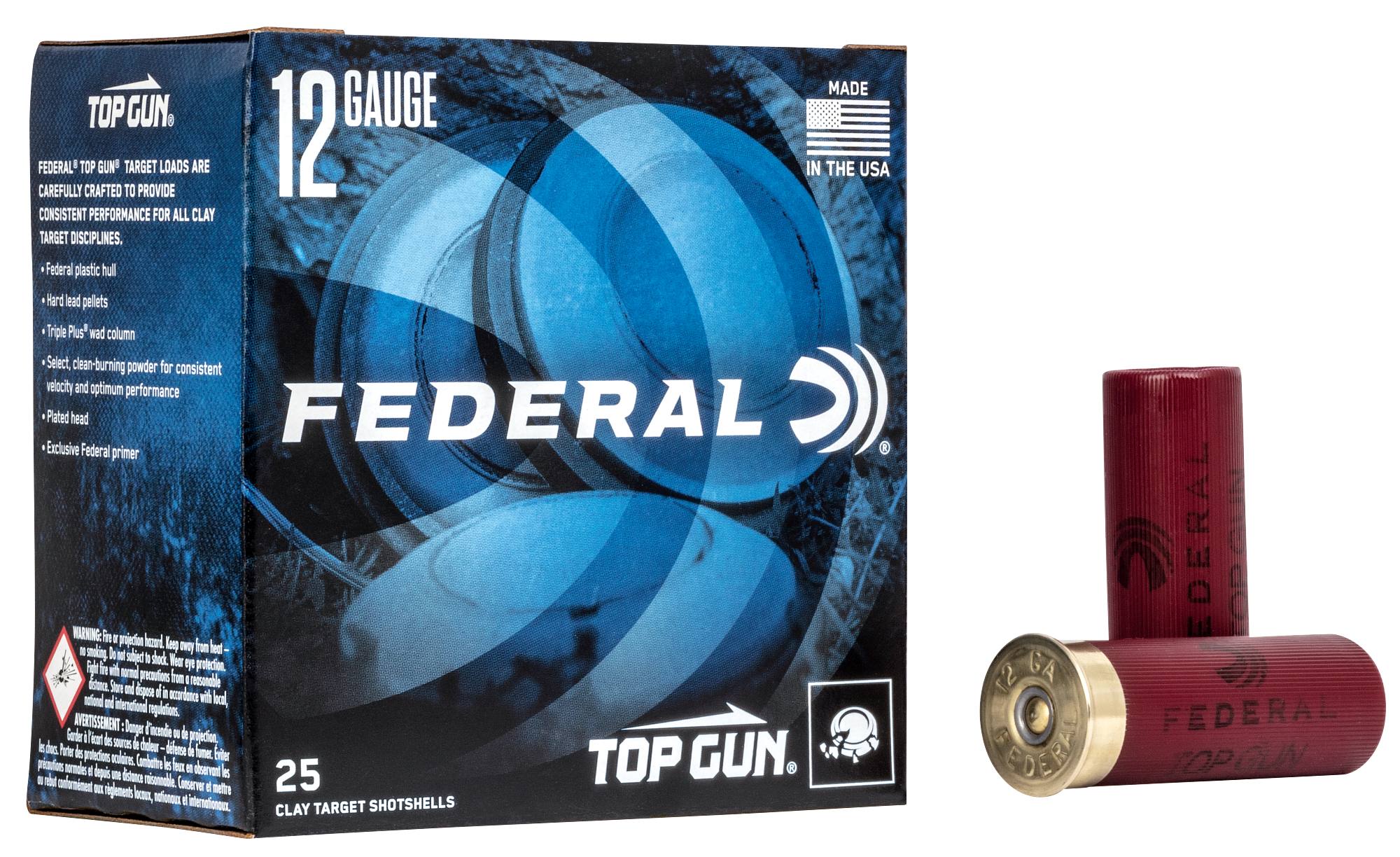

    Shopping for the Top Gun, 12 Gauge, 7.5 Shot, 2-3/4 in, 1 1/8 oz, 1200 fps - Learn more about the latest Top Gun and other hunting or shooting gear at Federal Ammunition.

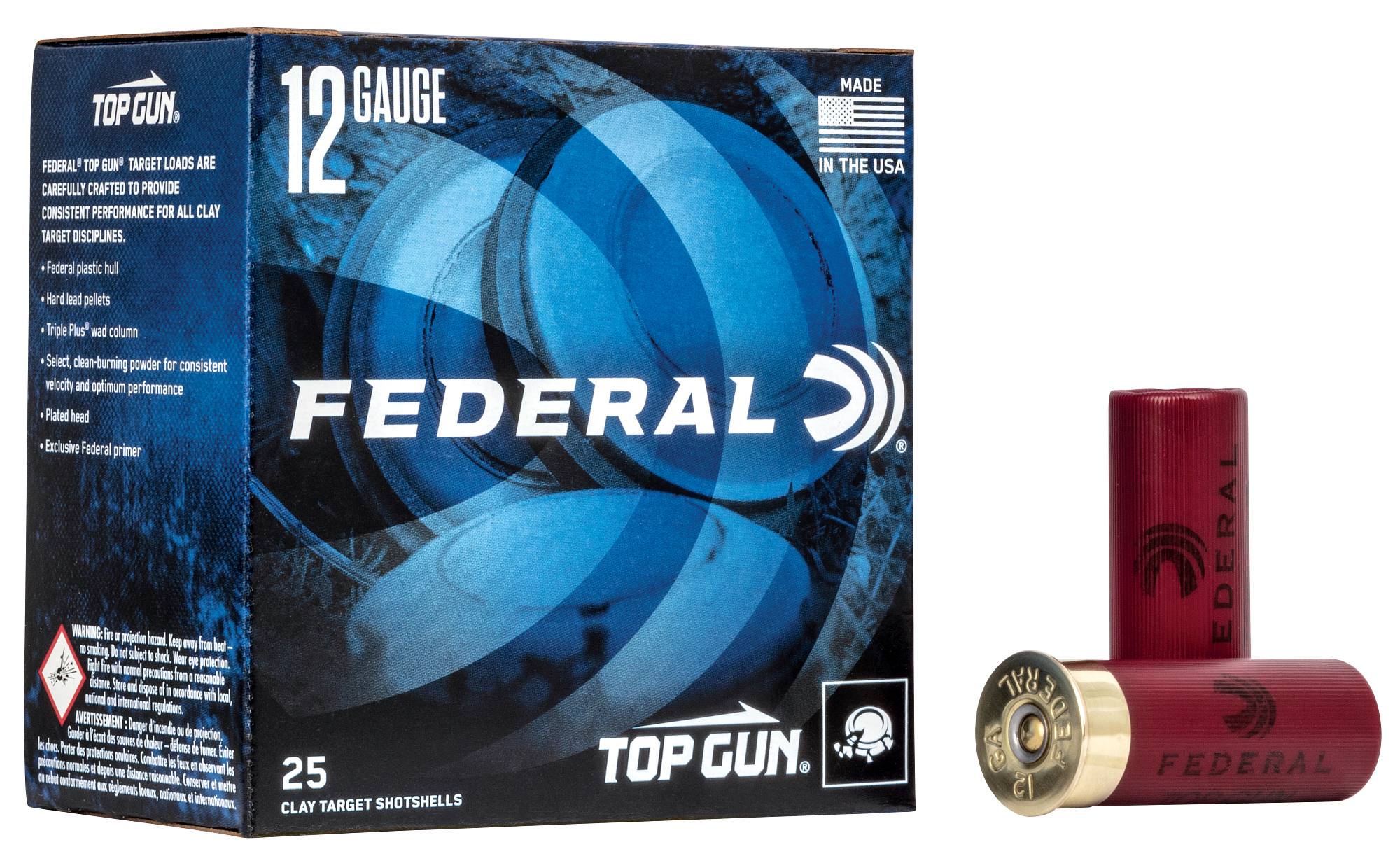

    Shopping for the Top Gun, 12 Gauge, 8 Shot, 2-3/4 in, 1 1/8 oz, 1145 fps - Learn more about the latest Top Gun and other hunting or shooting gear at Federal Ammunition.

    1-1/8oz of lead shot fits in 2-3/4" shells so I think you will find that there is little reason to load 1-1/8oz in longer shells unless you are talking about steel shot.

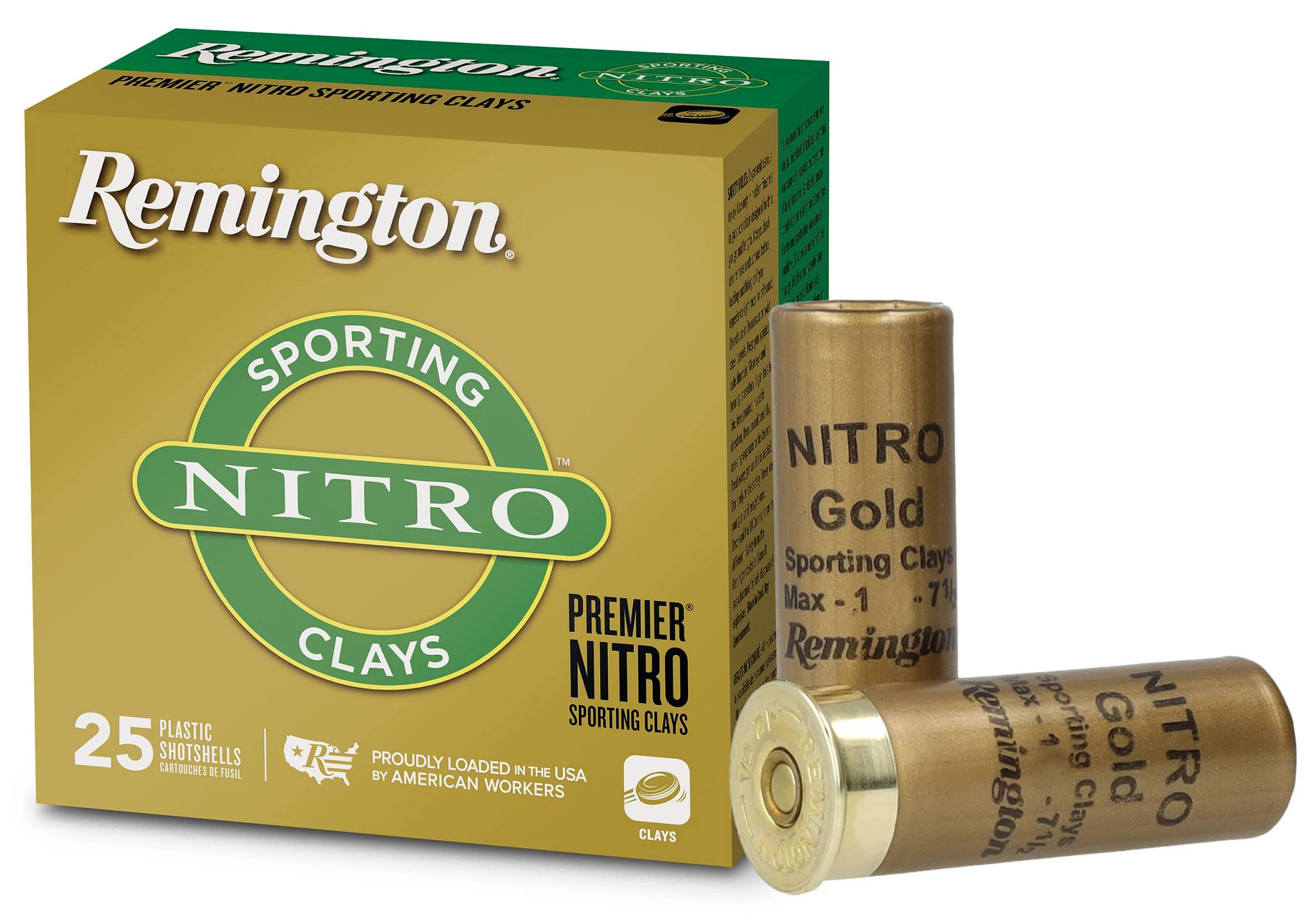

        Any shotgun that will take 3" shells will also take 2-3/4" ones.
        And you should check with the club as some have fps limits for trap & skeet to keep shot drop in a particular area.
        If you are looking for a load to break in a semi-auto, try some 2-3/4" sporting clays loads - 1-1/8 oz @ 1300 fps
        Like these -
        Shopping for the Premier Nitro Sporting Clays, 12 Gauge, 8 Shot, 2-3/4 in, 1 1/8 oz, 1300 fps - Learn more about the latest Premier Nitro Sporting Clays and other hunting or shooting gear at Remington.
        or some pheasant loads but they are not usually available in 7.5 or smaller shot sizes ; #4 & #6
