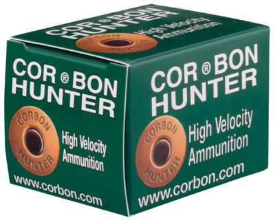

                I used to shoot Corbon's very similar to these
                Corbon Hunter Ammunition HT454320FPPN, 454 Casull, Flat Point, 320 GR, 1600 fps, 20 Rd/bx CORBON/GLASER(DAKOTA AMMO Premium Hunting Ammunition Cor-Bon loads hit with more authority and a s
                    http://www.ableammo.com/catalog/corb...x-p-75152.html
                    Im to cheap to shell out for factory ammo : )
