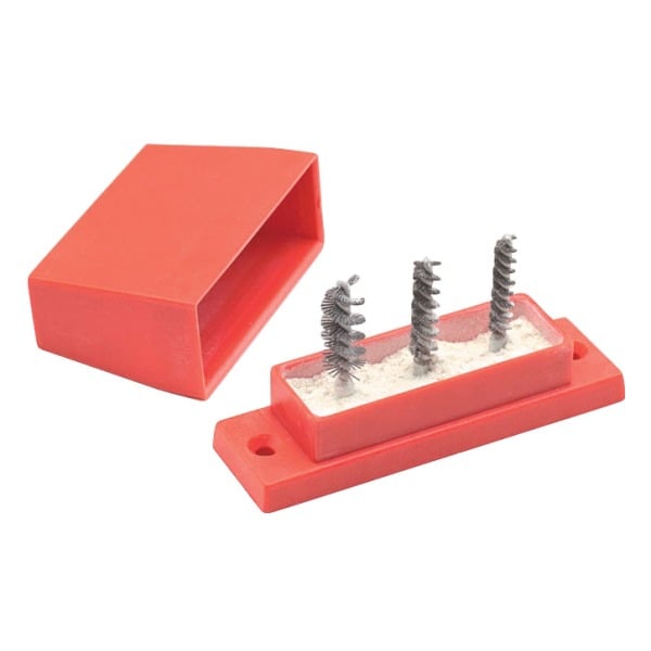

        Some use a powdered mica. It comes with a little tray and brush attachment to clean and spread the mica.

                        Powder mica....as in makeup?
                        This is the setup for case neck lube.
                        Count on the Forster Case Graphiter to help you get precise, repeatable results. Reliable reloading equipment. Shop it today at Graf & Sons.
                        It is the same stuff but the cosmetic version is finer powder usually mixed with additives so not so good for case necks more for old lady necks.
                        It is called Motor Mica.
                        Be careful using case lubes or homemade lube in the neck you might ruin the powder over time.
