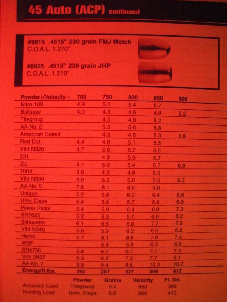

                      Originally posted by Sub95
                      Yeah i can see that 4 grains yields 700fps. I like to get around 850, and thats what my books data will yield. It looks like our data compares on that one.
                      Thanks for the info, guys.
