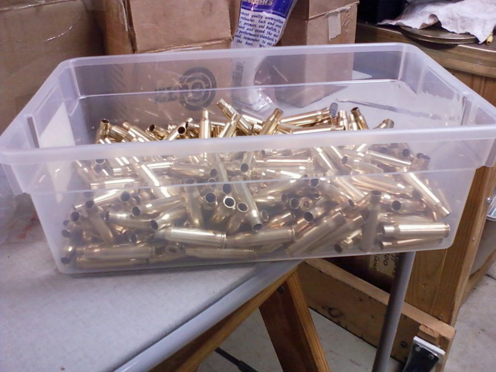

                  Worked pretty good, V. Still have the 3 gal of 223 to work on, but that wasn't the priority.
                  I had some 308 that was trimmed once, then fired & neck-sized 4 times. Then I had a bunch of once fired as well & some new.
                  The 30-06, I had a combo of new, once fired & twice fired.
                  When I do the 223, I think I will resize first on the 650 & then run it through the trimmer on my Rockchucker. Gotta get rid of those old primers one way or the other. Gonna try it the other.
                  The 308
                  The 30-06
