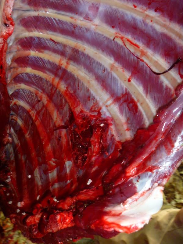

    Check out what a handloaded Sierra 150-grain GameKing does!!! The enterance!

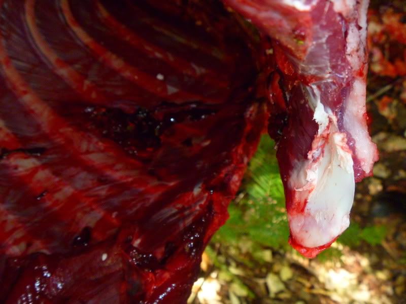

    Not much of an exit, the bullet shattered into pieces!
    There was a defined entrance wound, but there definitely wasn't a sure exit hole. The bullet broke into pieces as soon as it entered the skin and fragmented bullet shards cut up the lungs and heart into a pulp. So I didn't even want to bother showing the results of those vital organs, it was all a bloody mess.
    GameKings are really lethal against thin skinned game, but now I want to look into some kind of bullet retention and maybe even be able to make a bullet pass through an animal but still have the same knock down power.
