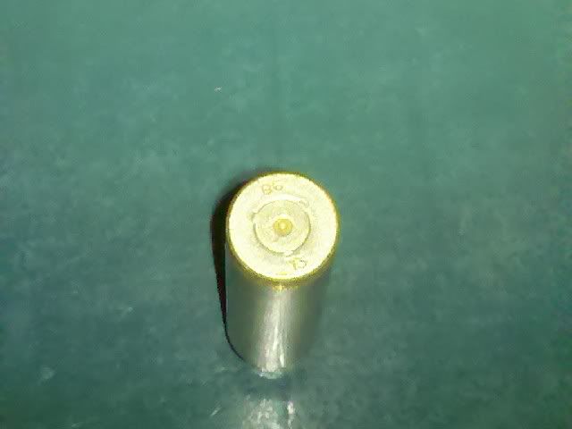

    I found my first berdan .223 the other day in some range pickup; it's pretty rare. It should be on the top of my scrap bucket, so I'll check it later tonight and post the name.

          I found that berdan .223 that I was talking about.
          It's a crappy cell phone pic, but the headstamp only says "86 13".
          You can also tell that the primers are staked in there.
          I would get at least one depriming pin on order and then start processing. If it breaks, then so be it. I don't know about Dillon dies, but Lee dies have a collet that lets the pin slide up to avoid damage on some calibers.

                  I think I have some 30-06 boxer brass that has staked primers, so it is not a guarantee that it is berdan. Maybe it is in .223, but I am just saying that you shouldn't consider anything absolute.

                    The staked primers are usually berdan primed. The only headstamp I have come across that were berdan primed is the 86 13 as pictured above. Good luck and it is always a good idea to have extra decapping pins.

                      The Greek HXP 30.06 has staked primers but is boxer primed. Not everything that is staked is berdan.
