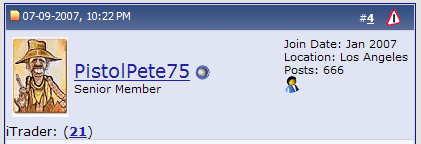

                ar15barrels
                • 56953
                Wicked post count.
                You need to post again, and soon!

                      PistolPete75
                      • Jan 2007
                      • 5230
                      Wicked post count.
                      post for 667
