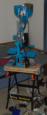

                              You need a strong place to mount it.
                              I would be comfortable saying that a strong place is really nice to have, but if you're space-limited like me, I'm actually doing pretty decently with this setup. Folding tool table from Dixieline, a solid piece of wood clamped to the top, and the press (on the strong mount from Dillon) bolted securely to the piece of wood.
