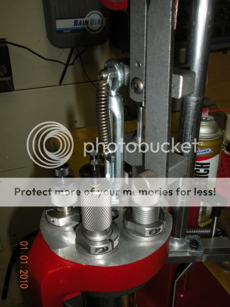

    Now I also use a PTX (Powder through expander) and I had also experienced that using the PTX forces the powder insert to the top of its travel - that's how the PTX creates the necessary pressure when belling. I figured I should also make a gadget like the one in the video.
    But guess what? Good ol' Home Depot already sells such a gadget! It's called a turnbuckle, and I already had a bunch of them on my wife's clothes line.
    I bought the regular steel type, not the SS model (they are too wide.) I screwed the reverse threaded end in completely and measured how much to cut off, then trimmed off the excess threaded section with a dremel. On the other end I installed a regular 1/4" bolt. I put a nut in the middle just so the stud sticking out of the powder measure would have something to butt up against, but I think this would work equally well with just the bolt and no nut. I applied blue threadlock on the bottom bolt. It's about $5 in parts.
    Now I can adjust the belling in two ways: by raising the entire powder measure or by screwing in the 1/4" bolt.
    First pic shows the turnbuckle at rest. Second pic shows the turnbuckle at full extension, when the PTX is applying the bell. Third pic shows the full extension from another angle.
    Ever since I installed this thing it's been smooth sailing. My powder measure doesn't wobble when loading and my PTX creates very even bells! (I use the powderfunnels.com PTX, BTW.)

                  The screwhead does not interfere with any part of the press, nor does it touch the dies when in operation. (In my setup I happen to have the metering insert toward the inside, but I could also swing the whole powder measure 180 degrees around.) The only thing affected is the range of motion for the metering insert. When at rest, the bolt floats about 0.5" above the press head. When at full extension, it's at about 1".
                  Right now I'm loading .40 and everything is adjusted accordingly. When loading something else I assume I'll have to readjust.
