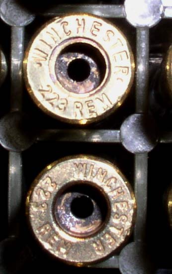

        Those sure sound like they had crimped primers.
        Post a picture.
        A deburring tool works great for removing the sharp edge.

            Here is a picture...
            The top one is crimped.
            The bottom one is not crimped.

              That's exactly it. They are crimped. Apparently my Lyman crimp remover does a piss poor job. I don't have enough brass to process to justify the $95 Dillon tool. I'll just keep using my deburring tool.
              Thanks a bunch.
