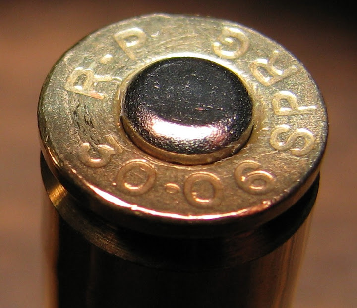

              30-06 springfield. umm. ya all i had to do was read the case in the pictures.
              so your not doing anything wrong. but you have several options. 1. deal with it and seat them hard. or get a hand primer. then prime them. if you can wait i would get a hand priming system. anyone will do. weather rcbs lee they are rather cheap and are very quick to use.

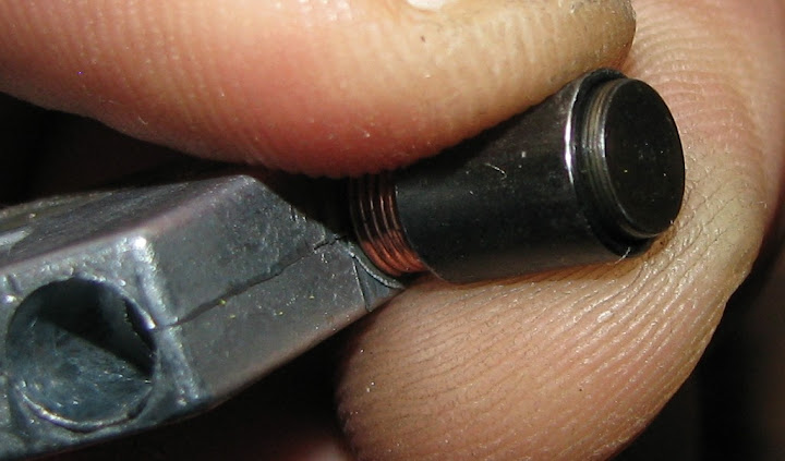

                      Thanks for the quick replies. I hadn't realized it, but there is an adjustment on the primer arm. It was set to not seat the primer all the way in - which is exactly what it was doing.
                      I adjusted it to seat it just below flush (~0.003" - just like the Lyman Reloading manual recommends), but it would only seat them to flush. I grabbed some factory ammo to make sure I was measuring correctly - Winchester factory ammo's primers are seated to 0.004" below flush according to my calipers.
                      I over-adjusted it to around double the thickness of my fingernail, and slowly seated the primers again. They remained at flush. I'm about to give up on this thing and just get a hand-priming tool.
                      Primer Arm:

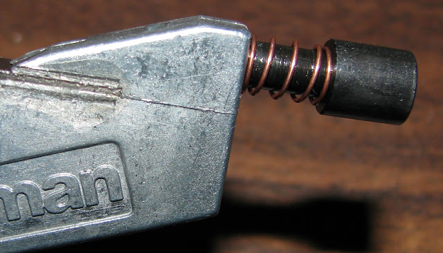

                      WAY over adjusted...it should have seated the primer too deep...but didn't budge it past flush:
                      I may use a grinder and slightly bevel the edge of the part of this tool that presses the primer into the pocket (the piece that's exposed when I pull the 'collar' back in the above photo), because I believe that it having such a square edge may be the reason why it's not 'slipping' into the primer pocket. I'm thinking that this piece is simply catching on the brass - not lining up perfectly with the primer, which is why each primer is perfectly flush.
                          That spring loaded cup has more travel than it needs so that the spring does NOT go to coil-bind in normal use.
                          Check the travel of the primer ram into a case WITHOUT a primer.
