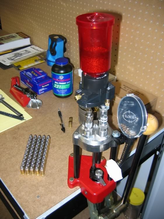

                          I have the Classic Turret, very happy with it, good beginner setup, and if you ever graduate to a progressive you will probably STILL use the Classic for doing low-volume, critical stuff.
                          Here's what you'll need. The part numbers are for Midway, prices shown were valid 5 months ago when I compiled this list:
                          -- Lee classic turret press, #81475, $74.99 (this was a sale price at that time; might be $10 higher now if not on sale)
                          -- Pro auto disk powder measure, #348753, $30.99
                          -- auto disk powder measure riser, #114080, $6.99
                          -- adjustable charge bar for powder measure, #150005, $10.29
                          -- safety prime (for large & small primers), #548630, $19.99
                          -- safety magnetic scale (to double-check the disk powder measure), #712103, $18.99
                          Comments on above items:
                          -- you will also need to buy die set(s) for your desired caliber(s). If you're loading straight-walled pistol brass, you should buy the Lee 4-die sets that include their very popular Factory Crimp die.
                          -- i included the adjustable charge bar because it gives you much more control over throwing an exact powder charge (versus the non-adjustable disks that come with the Pro powder measure kit; if that doesn't make sense, PM me and I'll explain it better)
                          -- the scale I included above is not a great one, but okay for beginning user to load pistol rounds with. if you're going to load rifle rounds for high accuracy you're going to want to get a better scale eventually (as I plan on doing)
                          -- the press comes with one turret. If you're going to load for multiple calibers, you should get an additional turret for each one. The sweet thing about this press is that once you get your dies all dialed in and adjusted for each step correctly, that's all you ever have to do. You lock 'em down and you're done with it. When you want to load a different caliber, you just put in the turret with those dies, and you can start loading right away. No time wasted figuring everything out again.
                          -- you'll also need some calipers to measure overall length (OAL) and crimp. Midway sells a good-quality digital caliper made by Frankford Arsenal for about $25 or $30.
                          I can load +100 rounds per hour on mine (.45) but I'm slow and methodical, measuring my powder throws/OAL/crimp every 10 rounds. I've heard of people loading 200-300 rounds per hour with these.
                          You can't go wrong with this press if you're a beginner. I'd have to shoot an awful lot more than I do now before I'd start looking at a progressive, although they are nice if you've got the scrilla, no doubt.
                          Edited to add photo of my setup:
