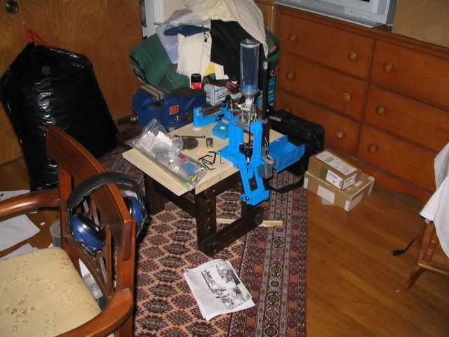

                          I've seen the Dillon Square Deal go regularly for $200 used. I just sold 2 at that price just a few months ago 'cause I found them local, and they followed me home. Keep your eyes out in the usual places, and if you're not in a huge hurry, you can find one. Square deal comes with dies, so that saves another $50 on the front end.
                          Also, don't forget your "extras":
                          caliber conversion and dies
                          powder scale
                          dial caliper
                          primer flip tray
                          case tumbler
                          Hornady one shot case lube
                          Loading manual or 2 (amazon.com) I found the Lee manual to be very helpful in .45 and 9mm.
                          I got my mechanical balance scale on Ebay for $25. . .primer flip tray from Midway for ~$3 (it works), and I had a pair of cheap chinese dial calipers that I've used for years and years on other things. If you buy new from dillon (which is inside your budget if you go Square Deal) buy it from Brian Enos.
                          www.brianenos.com free shipping, good prices, and TONS of gettings started info and support.
                          You'd be surprised how small a footprint you can set up a functional loading bench in (here's mine). I just started loading a very short while ago. Wife got me a 550 for Xmas
