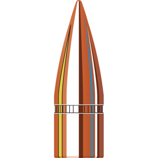

                              The PPU/Prvi Partizan .310 projectiles are a good budget option
                              Prvi Partizan was founded in 1928 and today produces over 350 types of rifle, pistol , revolver and small arms ammunition. Prvi Partizan bulk bullets feature a lead core and copper jacket. Imported from Serbia. Full Metal Jacket (FMJ) bullets are nonexpanding bullets with a full-length jacket opened at the base only. D
                              and when I feel like splurging I'll use the Hornady, but mainly I reserve that for the AR in x39 since it's the only gun that would notice the improvement.
                              Hornady Traditional and FMJ bullets are built with a rugged AMP® bullet jacket (Advanced Manufacturing Process) that clearly delivers better performance. The thin-plated full metal jacket offered by other manufacturers is easily distorted and often breaks or separates when the bullet impacts the target. The Hornady AMP
                              I would never use the .308 125 gr projectiles, I'll leave those for the 300BO shooters.
