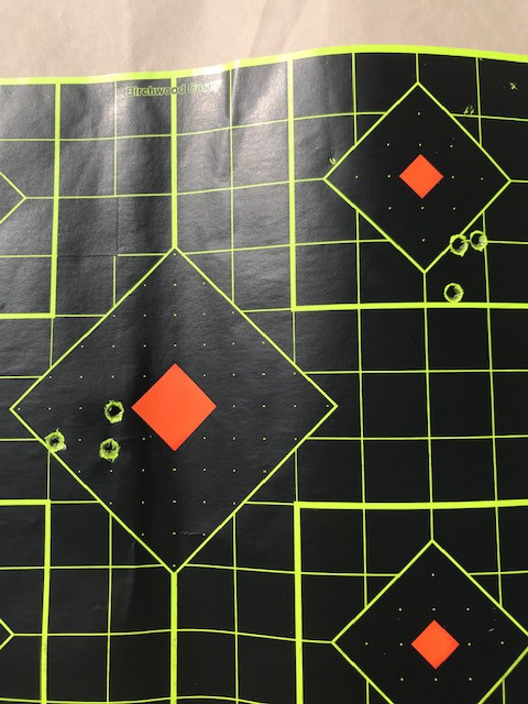

                        jr-abs
                        • May 2015
                        • 53
                        Here is a couple of groups at 300 yards.
