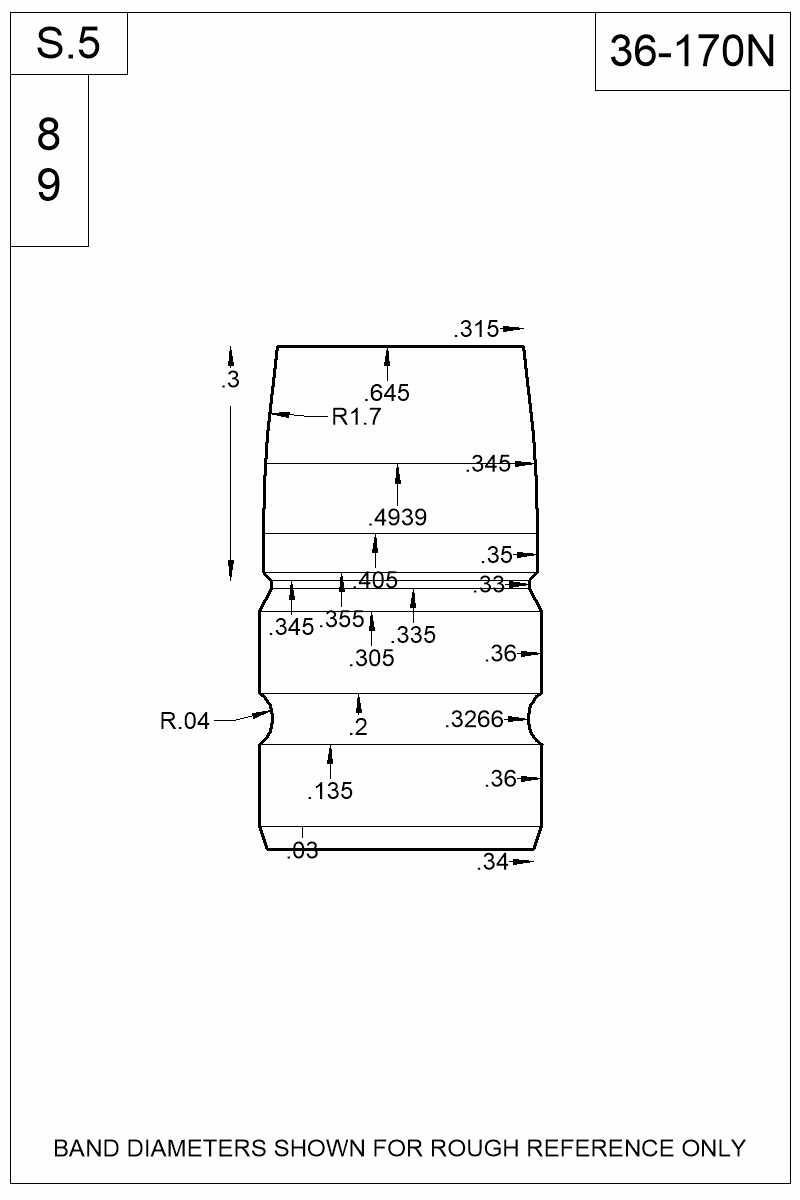

    I load a different bullet that's a similar weight. 170gr
    Description: 36-170n
    Notes 1: 1.125 3.8gr be-86
    Notes 2:

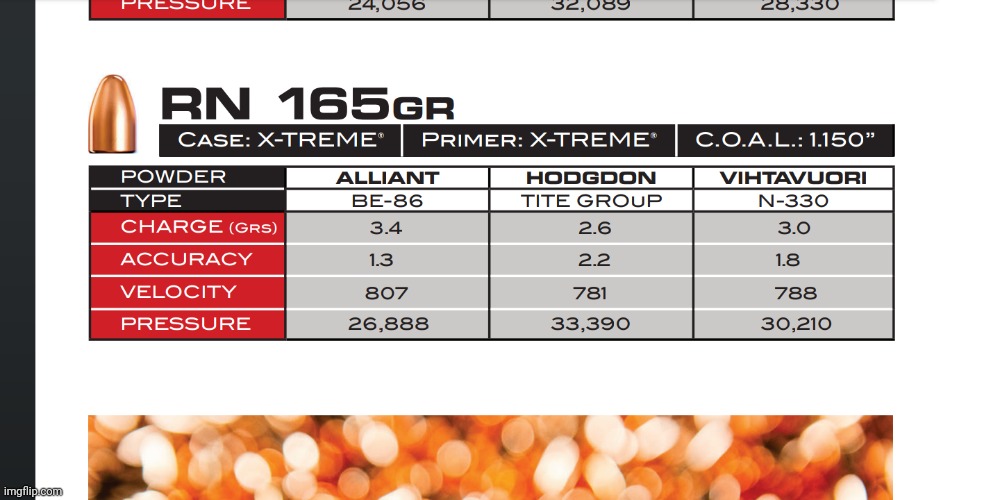

    If you go to Xtreme website i think you can download their load data book.
