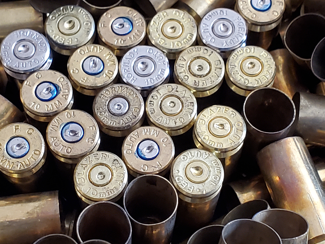

    SPP/SRP in 10mm brass might prevent cratering. Most 10mms use a 9mm firing pin, and use LPP in the brass. I always get lots of primer cratering, which a smaller primer might prevent. I need to get some SPP 10mm brass and try it.
      How many you want?😁
        To fix primer cratering you need to first address the firing pin hole and chamfer.

                I used to reload aluminum 9mm cases and 45ACP SPP cases and save them for when I go out to BLM land. I still picked them up but if I couldn't find all of then, I wouldn't worry about it. I also have a bunch of SPP 10mm cases and load them up for the times if/when I go to a range where they don't let you collect your own brass. Of course, if I know they won't let you collect your own brass, I probably won't give them my business.
                To answer your question:
                They all go boom and they all chrony the same.

                  I’m quite familiar with SPP and .45 ACP but who manufactures 10mm with SPP?

                          Originally posted by TAS
                          I?m quite familiar with SPP and .45 ACP but who manufactures 10mm with SPP?
                          Here are a few:
