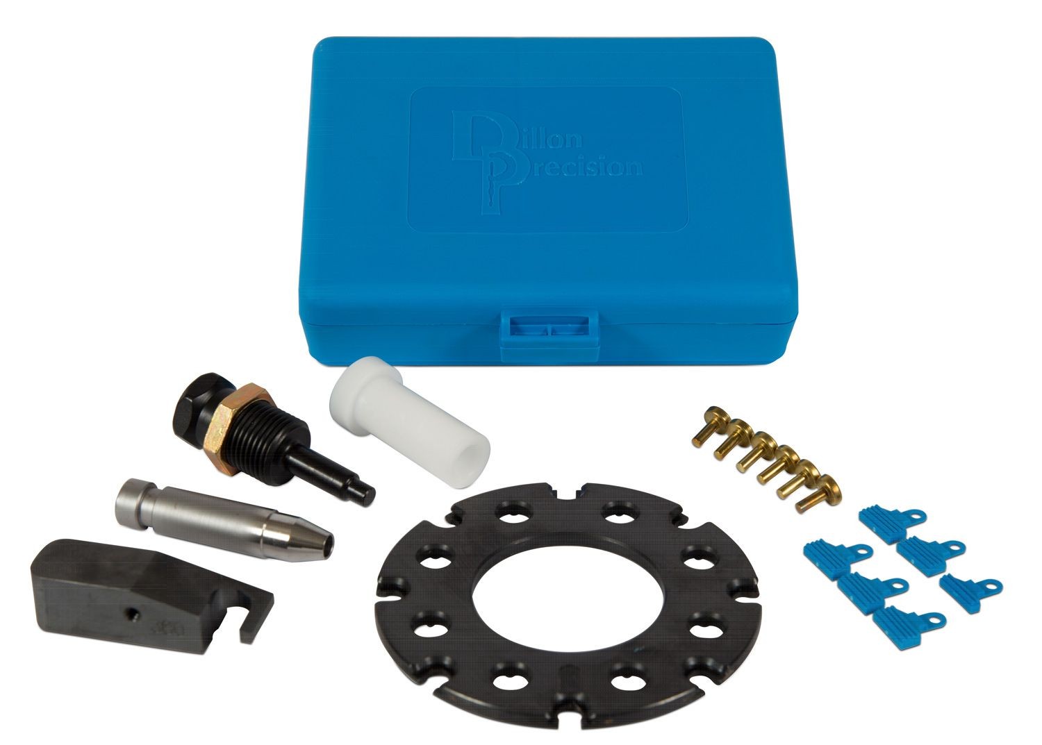

          I had this problem for awhile and what I ultimately ended up doing was tracking down a powder drop from the 1050. Its tapered not bell shaped so it doesnt stretch the case but puts a flare on so the bullets still sit ok (I use a 550b).
          Heres a picture I pulled from the net. Its the second part up on the left.

            I wonder why the have different designs for the funnel. The video i found on YT where the guy slices off the end of the funnel said that the funnels used to be shorter. Wonder why they changed the SDB part to make it longer while the part for the 1050 doesn't have the cylindrical portion at all.
            I am guessing it has to do with rounding out the ID of the case. The Stage 1 die just works on the outside of the case. So maybe they put the neck on the SDB funnel to round out the inside. I don't know the detail of the 1050 but maybe the machine works the ID at a different stage?
