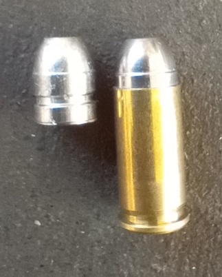

                That's a good reason to cast. Here's a flat nose bullet I cast from a modified Lee rifle mold. Got the idea from another forum. It drops at .310" and weighs 73 grains. I load it to .900" and it functions in all my 32's. Accurate makes several good molds from 60gn to 77gn that would work well also.

                  Which mold did you use and how did you modify it?

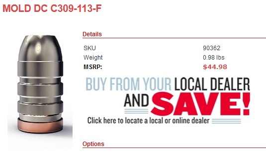

                    my guess is you take mold 9030 unscrew the sprue plate mill off 1/8 inch off the top

                      Close. I milled the Lee 90362.
                          This is definitely something to consider if you plan to reload for this gun. If not interested in casting maybe OP can find some proper boolits from someone.
