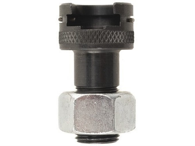

      Pretty sure this is not the case. The shell holders are different, and peculiar to that press. RCBS does make an adapter, though.
      Hollywood press die for 30-06:
      RCBS adapter:

        Yes it is useable. She'll holders are no longer made but can be found on eBay. There is also an adapter available but it will raise the height of the shell holder and may affect Camover.
              Sorry, you are right. It's been a long time, but I think I might have made an adapter for a guy maybe 35-40 years ago.
              Cam over Machinists might call it going past center, or over center. I'm not the expert FG is though. I did work for several years at Star Machine Works making parts for reloaders and Lubri-Sizers. The travel past center of the Lubri-Sizer is used to pump the lube into the grooves of the projectile. Simple and brilliant idea. Still sold today by Magma. The inventor, Elard Mock, never used the term "cam-over."
              Might be able to just install the die bodies higher and still get the desired "cam over."
              ETA: OP, if you cant find an adapter, I could likely make one for you. I'd just hate for that to go in the scrap heap for lack of a small part. Or maybe sell the press to someone that already has one.
