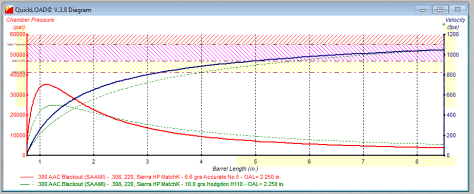

            Does anyone have a pet load for 300 BO subsonic with 220 gr SMK and H110 powder? I loaded up some 220’s with 8.2 gr of H110 and shot them through my 8.5” barrel with suppressor and was not quiet as I had hoped. I hate to keep wasting expensive bullets and losing my brass and was hoping someone already had a good load for me to experiment with.
            If your load is subsonic, then your can is likely just as quiet as it's going to ever be with H110.
            What you can do is move to a faster powder than h110 which will give you a lower pressure at the muzzle.
            That will quiet it down more.
            Also, go to heavier bullets.
            The heavier the bullet, the less powder you can run and therefore the lower the muzzle pressure.
            Muzzle pressure is what generates the noise once you are subsonic.
            A longer barrel will also lower the muzzle pressure as it will contain the pressure longer and allow you to use a lower charge to get to 1050fps.
            Here is H110 compared to AA#5, with both loaded to 1050fps in an 8.5" barrel:
            The pressure at the muzzle with H110 is about 5600psi while it's 3600psi with AA#5.
