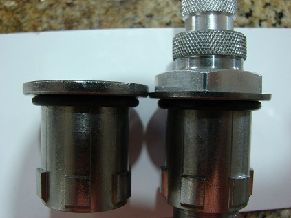

                    Originally posted by sdnative13
                    I am I the process of loading up some .223/556. It is all mixed brass. My problem is when I try to resize neither my rcbs or redding die works. I run out of threads before I can get the case properly sized. When I move the die to my rock chucker it works fine but a lot slower. Any suggestions.
                    The LnL is sometimes right on the edge of allowing some dies to adjust deep enough. I've had issues with different die brands that required the thickness of the bushing to be machined down so the die could reach the shell plate. Here's one example of a Lee die that wouldn't thread in deep enough to work properly so I had to cut down the LnL bushing.
