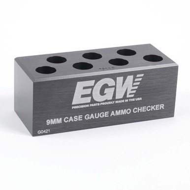

                          Buy one of these chamber checker's
                          Optimize your reloading process with the Evolution Gun Works 9mm Case Gauge Ammo Checker. Crafted from aircraft-grade aluminum, it ensures precise measurements for reliable ammunition.
