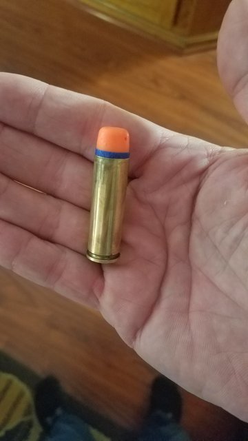

    .50cal nerf bullet.
    Saw these on youtube had to make my own. Fun to shoot in the back yard.

    Details please. I've used glue gun segments in a 45acp.

      Wait, what?! You handload with primer, powder, and the Nerf bullet?
              No powder, regular or magnum primer only. I drill the flash hole one size bigger to keep the primer from backing out of the case as well on my 45acp or .38 loads.

                I'll give you guys a pro tip, get a cheap bullet mold and use a hot glue gun to make rubber bullets. Great for practice, I chronographed those at 450 ft per second out of a 40 Smith & Wesson. And you can reuse them almost indefinitely.
                Also a hot glue gun stick is 45 caliber, so in theory you can just cut it into slugs and put in a 45 case.
