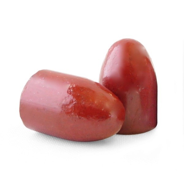

                              Laser cast loads that bullet to 1.10 and western powder loads it to 1.07, I'm with sofbak and the others in thinking you're loading it to long in a gun that can't accommodate, also .020 difference between 2 random rounds is kinda sloppy. Someone asked if you plunk tested, but what would that matter if the difference in your loaded length is .020? If you look at your bullet you can see it has a full diameter bearing surface about halfway up the bullet, meaning a .356, it looks like you got that part hanging way out of the case, if you have a short throat, lead and or htc build up, stuck on the .346 lands. Also, is it just me or do those crimp marks on the bullet seem a bit crooked, which would amplify your problem. Try loading them shorter.
                              Can you see the line where the diameter changes?
                              Here's a similar style, notice where the ogive starts, and how much bullet would be in the case.
