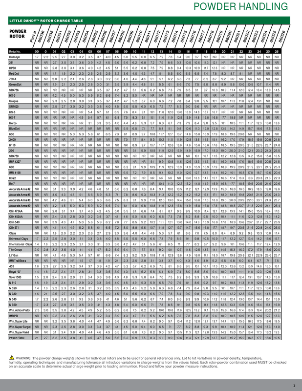

                An RCBS Li'l Dandy measures Unique just fine.
                Originally posted by pacrat
                ^^^QFT^^^
                To add to that..... The RCBS Li'l Dandy measures every "hard to meter" powder I ever tried, accurately and consistently. Unique, 700x, 800x, etc. It is a GREAT tool to have on the bench for pistol loading.
                  RCBS "Lil Dandy" I will have to see how much those are. Even with my progressive press I suppose I could load powder into each case at state 3 and go on from there.
                  • #39
                    bigbossman
                    • 11280
                    $45 from Midway, and then you buy the rotors you need. Rotors are about $12, also from Midway. You can also find them for around $10 on eBay.

                      The mechanical advantage of the Little Dandy. Is that flake powders such as Unique, Bullseye, Red Dot, and a plethora of others. Don't do well with LARGE DIA. adjustable spindle measures.
                      When adj to proper charge weight. The cavity is very large in diameter compared to the depth of the cavity. There is a lot of surface area which [shoves and shaves] kernels as the drum turns.
                      The Lil Dandy has rotor cavities specifically designed for SMALL capacity charges. With a limited surface area. Of the cavity. Mitigating the [shoving-shaving] problem.
                      The very WORST powder measure I ever had was a Lyman 55. Which has an adjustable cavity that sits horizontal in the drum. Creating a huge surface area of the cavity.
                      NOTE...... Even BALL powders meter more accurately with a Lil Dandy.
