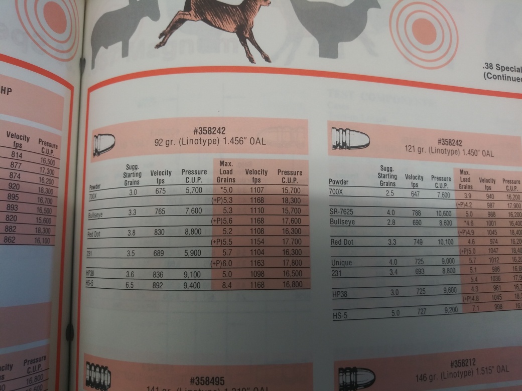

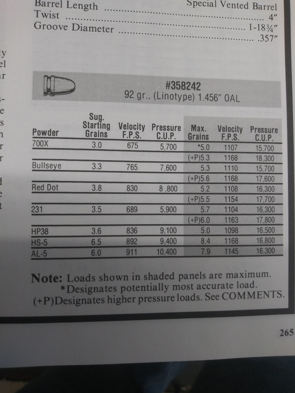

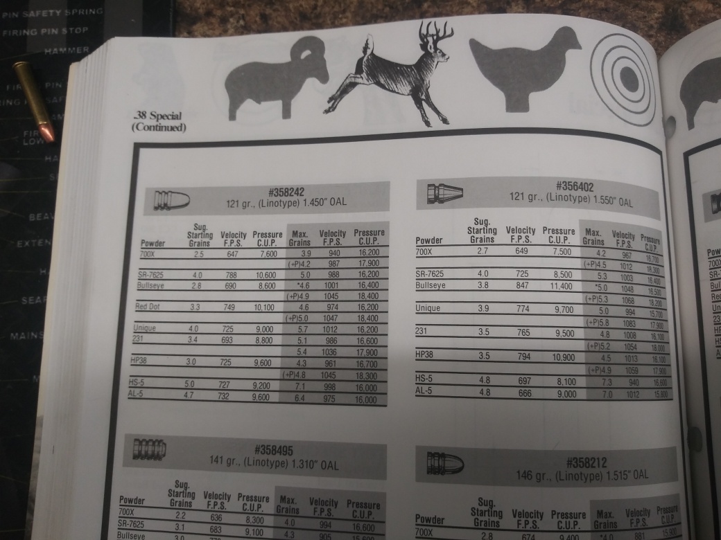

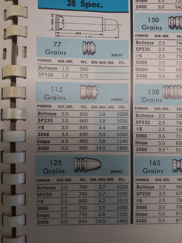

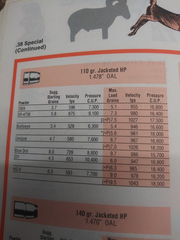

                      I couldn't find anything specific in my reloading books for a 105gr bullet, but the following pages will give you enough to work with. Nothing with Accurate #5, though:

                        cast book
