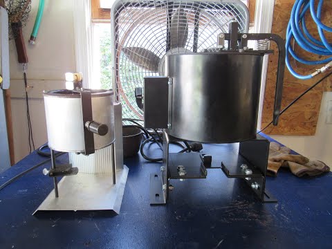

              I'm using a Lee 4-20 and it works. Drips but I've modded to fix that. Also built a PID to help with temp. The issue, I'll cast for about an hour I think the 20lbs of lead is gone and it takes awhile to melt another batch soooo....I bought another 4-20 lee and plan to mount that above and use it as my reserve pot so my bottom is always full. It's all about consistency.
              If you havent bought a pot yet, I'd get a magma 40lb master pot or a master caster. The master pot holds 40 lbs and thats a good amount. Thats about 1500 180gr bullets and would take probably 2-3 hours.

                Psychbiker
                • 1671
                Lee 4-20 next to a magma master pot
