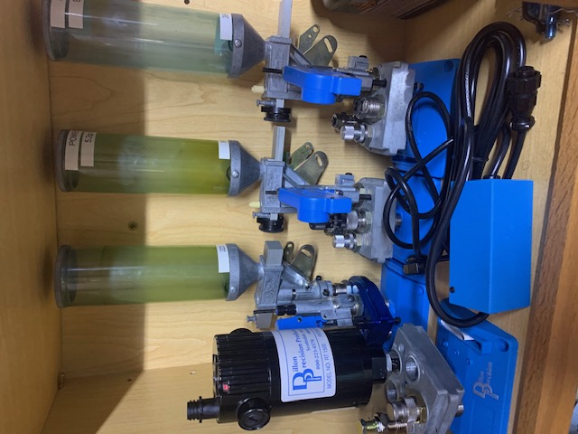

                              It's certainly possible to just use one tool head and one powder measure to reload multiple calibers. But who wants to setup the dies again once you've got them dialed in?
                              Plus taking off the powder die, putting in a different funnel, and then possibly swapping out the powder bar (Dillon makes 4 different sized powder bars, and there are aftermarket ones). And also installing the small or larger primer feed parts (a lot of 650 folks just bought another separate primer feed assembly to bolt on, I'm not sure how that works on the 750).
                              In the end your cabinet looks something like this:
