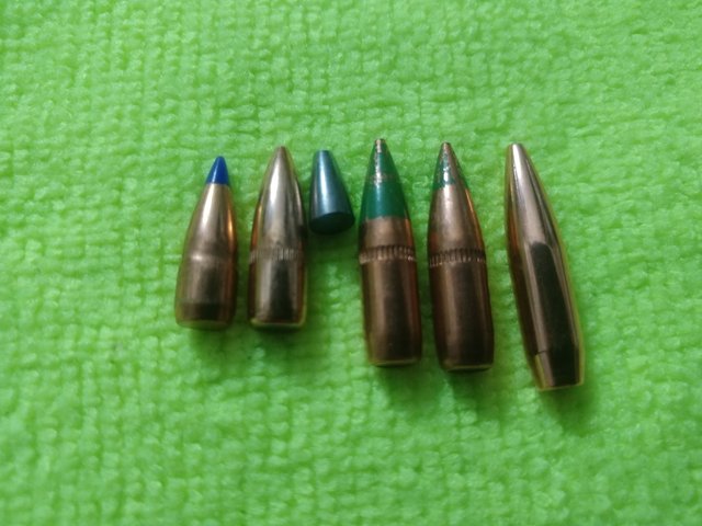

      You need a strong magnet. The one in photo is out of an old hard drive - very strong magnet.
      The steel core 62g is longer than a std FMJ 62g due to the lower density of the steel.
      SS109 = 0.91 " long vs 0.79" for non steel core 62g

          SS109/M855 projectiles have a SMALL steel tip, not a steel core.
          Lead does not encompass the steel tip, just the front part of the jacket.
          Calling these steel core is a loony as calling projectiles that contain steel... "magnetic".
          As I recall from ripping one apart, about 1/4+" steel pseudo pointed (mine had a flat tip at the very end, like a more gradual Truncated Cone) tip only. Not a steel CORE, but tipped.
          Here is one ground down:

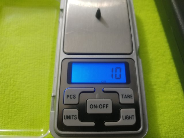

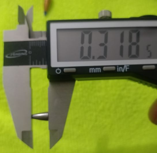

                      I busted one apart for y'all:
                      "JUST THE TIP", and ONLY FOR A MINUTE...
                      ONLY 10gr of the 62gr projectile...

                        NYIIIIIICE... I'm a cheapskate, so thanks for the sacrifice!

                          So the SS109 projectile has only 10 grains of steel that is just a pinch compared to a 50BMG MK263
                          I picked up the projectiles in the photo from the ground after a wild fire ran through a popular BLM shooting spot. The fire's heat melted the lead out and left the steel or steel and copper.
                          MK263 projectile = 750 grains
                          just Copper + Steel = 600 grains
                          just Steel core = 390 grains
