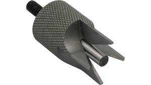

                          I have the deburring heads for the Hornady station thing (I don't have the station); I chuck them in a cordless handheld drill (mine has a 1/2" chuck) and just tap the cases to the tool. Not precise by any means, but gets the job done.
                          These things:

                            I use a Hornady hand chamfer tool, but it has been discontinued. This Lee case prep tool shown below might be a good option. I don't think I would use a power tool to deburr.
