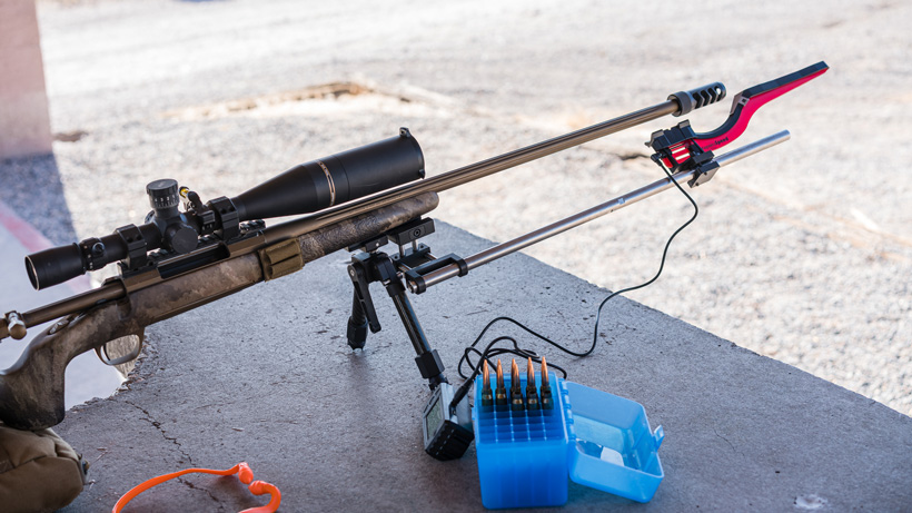

                There are mounts available that mount to your chassis or stock that have an extension rod to support the bayonet so it is not mounted to your barrel. Many are using it with success. Some need to be mounted on a chassis with straight sides vs a stock that has a tapered forend; you could probably figure out a way to use shims on a stock if necessary or use the picatinny rail if long enough (as in the picture below). I started using the MK Machine Gen 3 on a chassis and have never dropped a shot in over 600 rounds.
                Google Wiser Precision or MK Machining
                MK Machine Version
                      MK Machine Version

                          The rifle shoots 0.5 MOA with it off and with it on so I never concerned myself about POI shift; I zeroed the rifle with it on and always shoot in this configuration. If I were going to shoot with and without it, I'd zero in the configuration I was going to do most of my shooting and then use offsets, if necessary, for the other configuration. If you have any questions about doing this, shoot me a PM.
