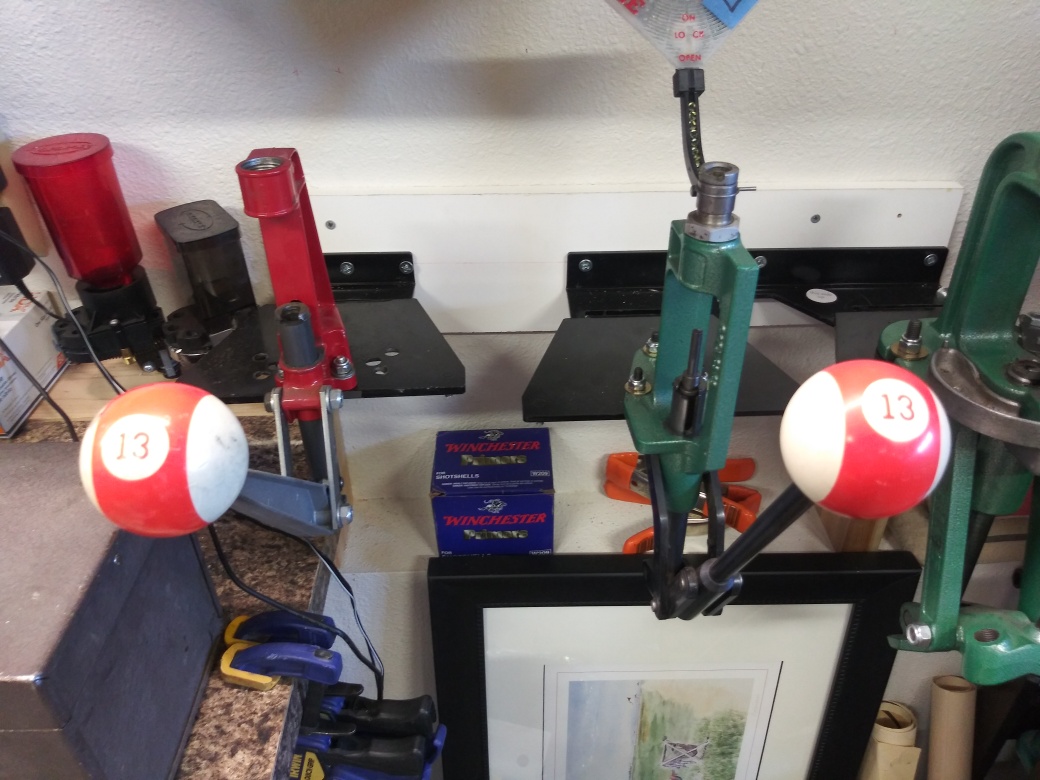

                          I have a roller handle on one of my presses. I prefer an oversized ball, so I outfitted all my presses with drilled and tapped billiard balls - fits my hand better.
                          Different strokes..... (no pun intended!!)

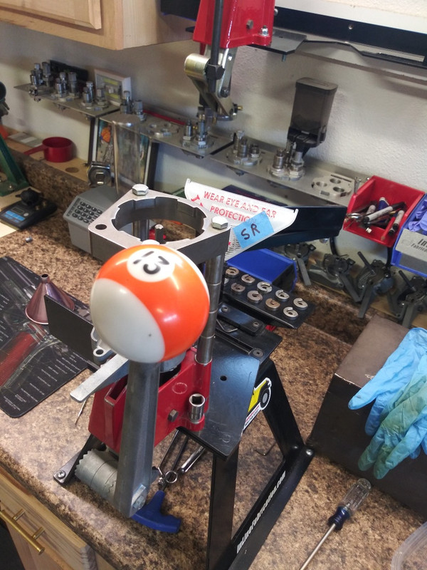

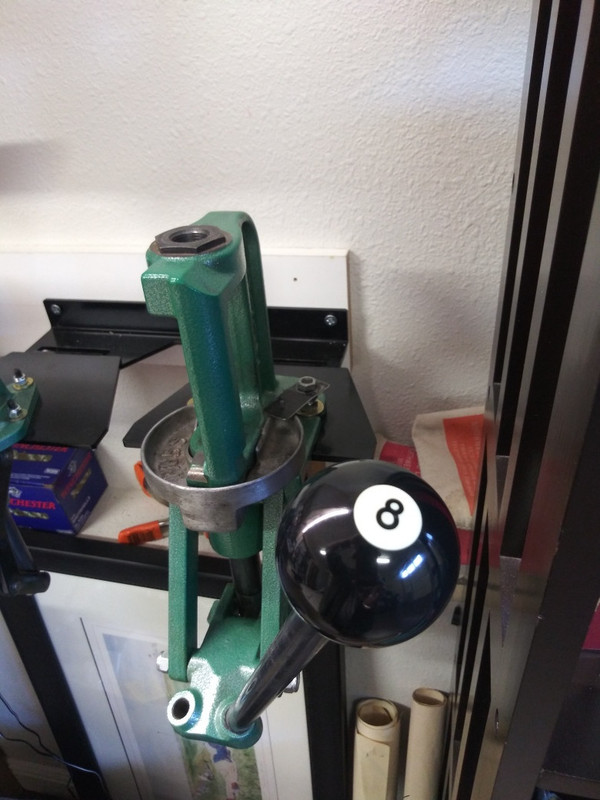

                              bigbossman
                              • 11321
                              Originally posted by divingin
                              First thing I thought of, too.
                              Just for fun:
