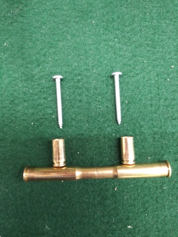

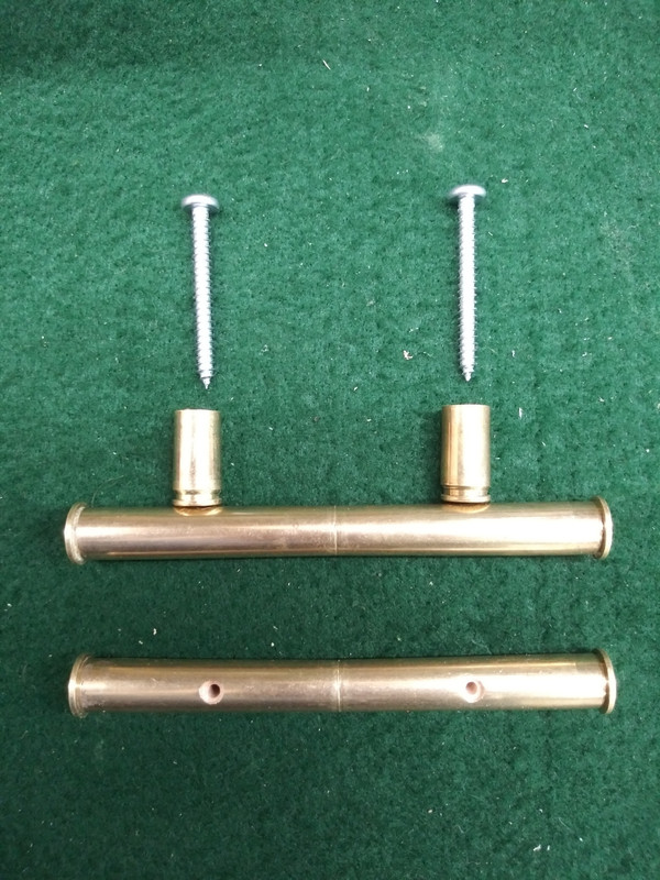

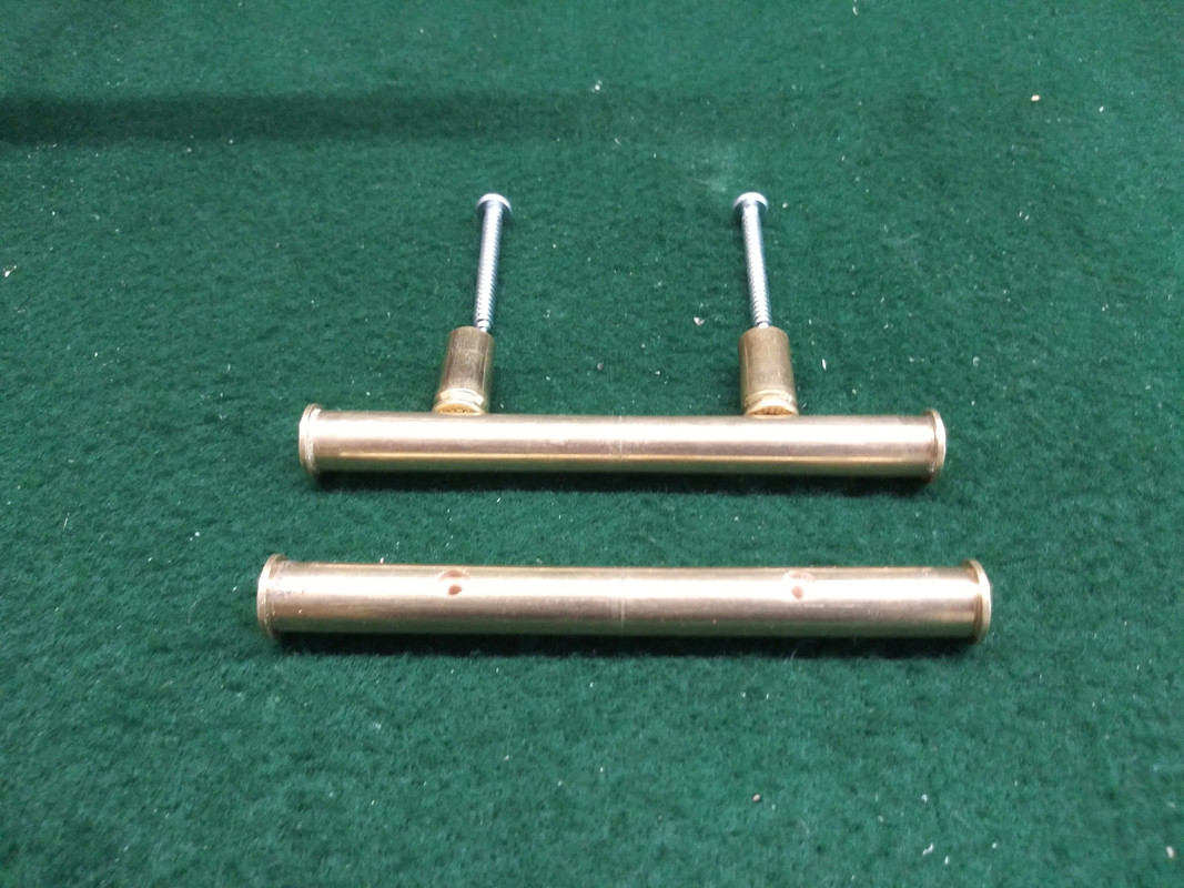

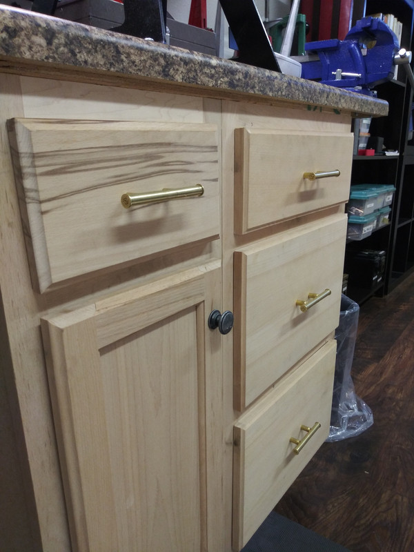

            Seems simple enough, and so that's what I did. I made two versions to see what I liked better..... both have 9mm casings for stand-offs, but one is made from 38-55 and the other 30-30 as pictured above. I've got a ton of all these cases, so no additional expense incurred..... and the 38-55's are all from my "end of life" pile, so win-win.
            The 38-55 is much easier to build because a 3/8" dowel is a press fit to the point that I used a small hobby mallet to drive the cases onto the dowel. No epoxy, no wiggle, never coming apart. On the other hand, the proper dowel for the 30-30 only fits snugly in the neck area, but not snugly enough. The casings can be easily slid off and onto the dowel,and there was a lot of air space between the dowel and the lower case body (I need to have drill-able material inside for the screw), so epoxy was required. Not a huge deal, but messy and time consuming to mix the epoxy and get it into the casing. Also, I needed to provide an escape for the air/excess epoxy as the dowel was inserted (I made a flat spot on the dowel center to solve that issue). I kind of like the sleek look of the 38-55 cases, so that's what I'm probably going to go with.
            As an aside, WRT to shot shell pulls - the 9mm casings look a little too long to replace the white nylon spacers.... looks a bit out of proportion to me. Maybe .380?

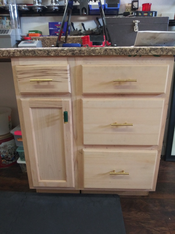

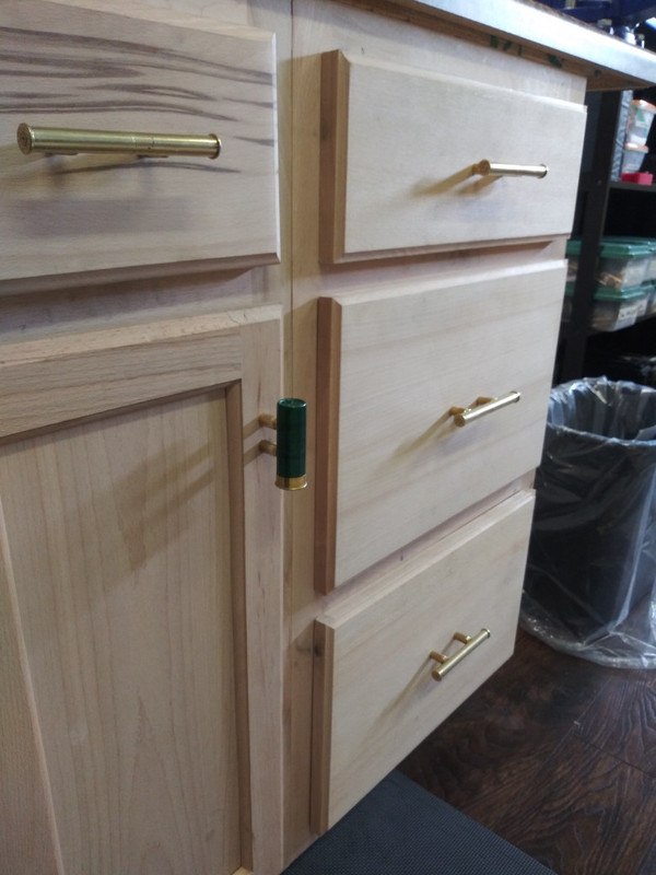

                First pass at installation complete. They look pretty good:

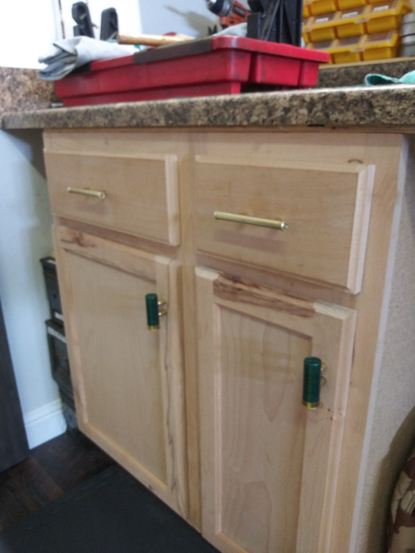

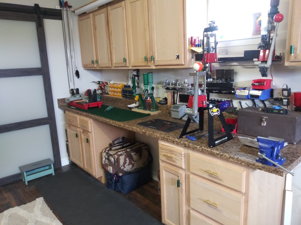

                    Ok - last set of pics below (I promise!), as I finished installation yesterday. I decided to switch the white nylon spacers out for .380 casings and it does look a lot better.

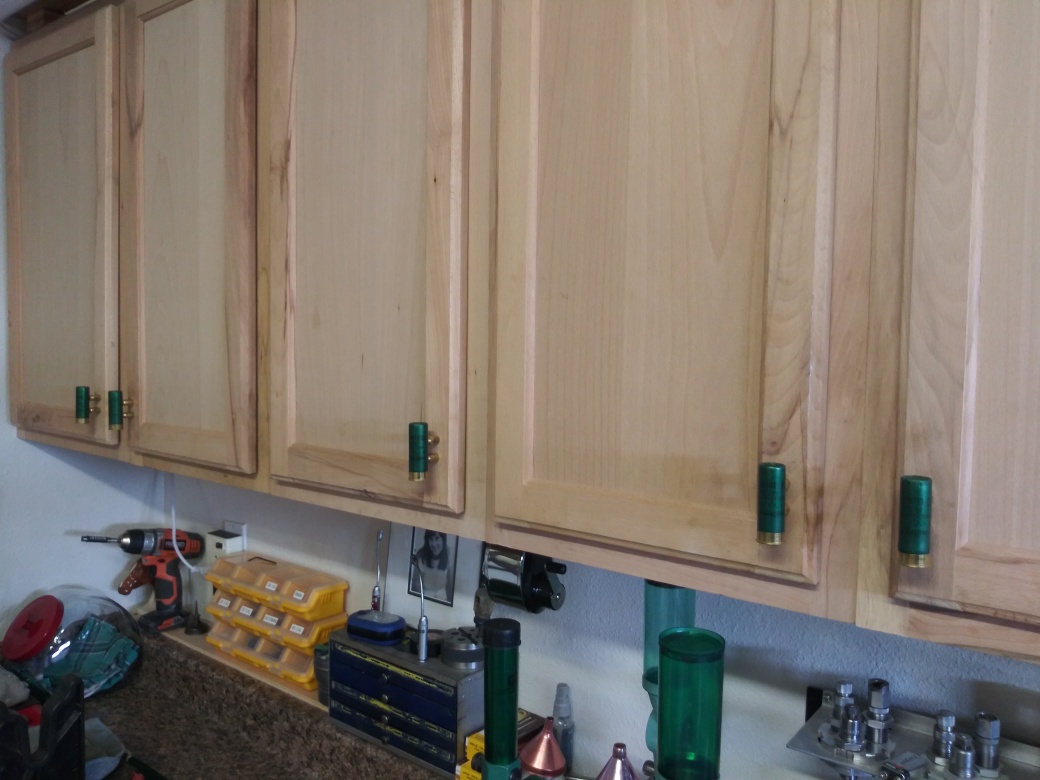

                      Love those 12 gauge pulls. May have to make some of my own. Thanks so much for posting this. Great ideas!

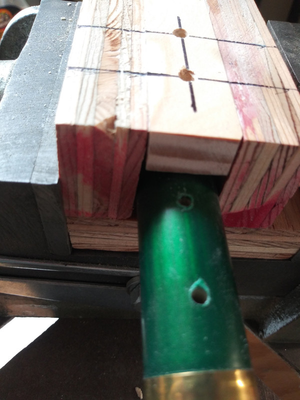

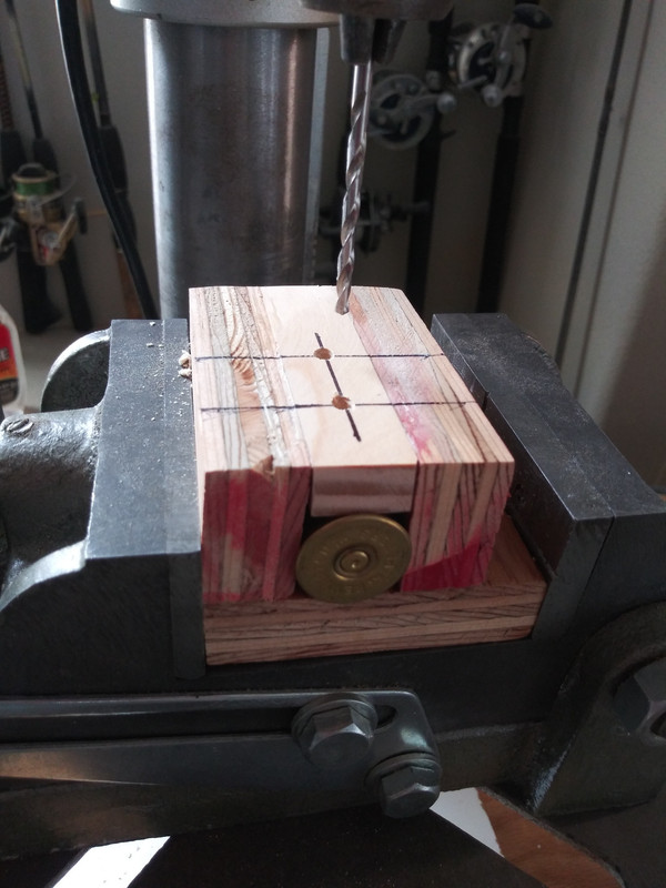

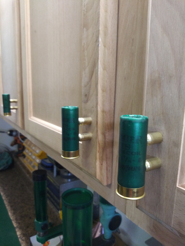

                        Nope, not retired. Once I doped out how to proceed, I made up some jigs from scrap and went to it. Pretty easy, not too time consuming. The hardest part was sanding down the dowels to fit into the 12 gauge hulls - the closest size was just a smidgen too large in diameter, and the bottom has to be tapered somewhat to seat properly in the bottom of the hull. Also, getting the correct length to ensure a good looking crimp took a bit of trial and error. Having a drill press did help quite a bit to keep the holes centered and perpendicular.
                        Like so:
