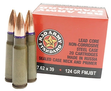

      I only tumble in cob, and use Brasso w/ some solvent like mineral spirits, or denatured alcohol and have never seen this happen. Could it be a reaction with something in the hulls and the brass, or do you think it is the polish?
      If it were once-fired, I think you could weed out the issue easier, but dang that is weird.
      Have you noticed any sealant on the crimp/throat, when it was factory ammo, like this?:
      Did you always, only tumble with hulls and polish?
      Were they looking normal before the tumble (aka any carbon at the neck)?
