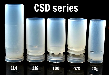

                      Steel wad:
                      Lead wad (this is one of the choices of the OXO-Bio):
                      Notice how the steel wad is not as "open" and fully encases the lead shot? this is done to protect the barrel.
                      On the other hand, lead shot wads have gaps between the petals, and in most cases the shot overflows the top of the wad slightly.
                      Depending on the cost/value of your shotgun it might not be worth it to try and reload steel shot in biodegradable wads designed for lead because of potential barrel damage. If I really wanted to try, I would probably get the 1 1/8 oz wad, and load 1oz of shot (to keep the shot inside of the wad) and use an overshot card on top of the lead for good crimps. I have no idea if this works, I'm just guessing at this point.

                              I'll share what I know about loading steel, wads and Kent Steel w/ degradable wads
                              All the steel shot wads I have for reloading have slits. All the factory steel shells I have shot, have slits....this is to shed the wad as in lead shells.
                              There are un-slited wad made, and the ones Bettle mentioned may be one of those....they are made so the reloader can add slits (2-4) to customize a load.
                              Slits are closed shut when in the shell and open after leaving the barrel.
                              The bio-wads that are used @ Richmond, IIRC, they sell them there also, can be used safely for steel as Kent is using the same slit, thin wall wads. Open up a Kent w/ bio wad shell and the wad looks like a lead wad would...slit and just as thick
                              Barrel damage....? small shot and thin wads looks to be fine for Kent. But all the steel wads I have seen and used are very thick.
                              I say ....reload...it will be the same type of wad Kent is using....but I would caution about using shot larger then what you can buy from Kent using the bio wad #7 may be the safe max.
                              Added ...when reloading steel make sure the shot is fully seated in the wad...the shot column should never be higher then the wad is tall
