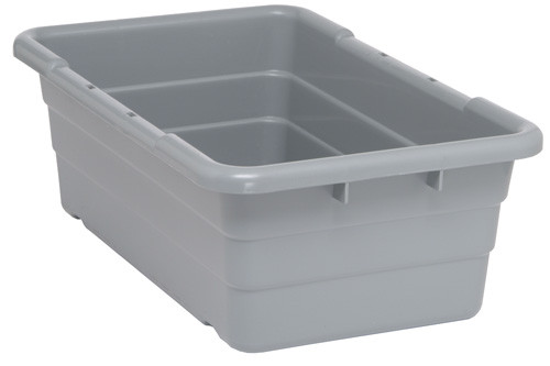

                  Get yourself a plastic container that the trimmer will fit into. Any shavings will fall into the container and you won't have a mess all over the place.
