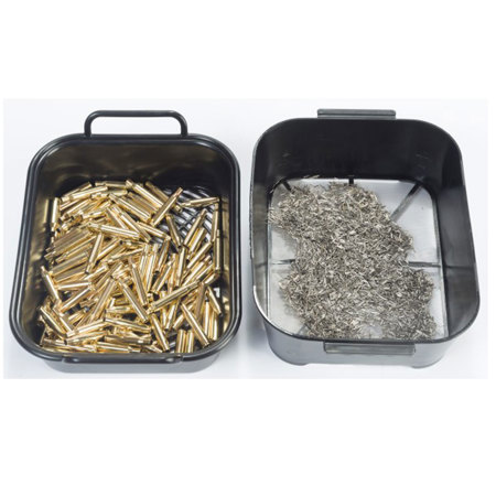

      I stack two gold sifting pans on top of a 5-gallon bucket, standard Home Depot Homer bucket.
      The top pan, on which the brass gets poured out, is this one; 1/4" mesh:
      The bottom pan, which catches the pins, is this one, 1/50" mesh:
      It works well and they're inexpensive. I use the Frankford tumbler, and it's completely full each time I use it. The pans are plenty high enough to contain everything.
      I recommend the transfer magnet that Frankford sells; no matter what method you end up going with, this will make things a lot easier:
        Milsurp Collector
        • 5884
        I use this. It works very well. Just dump the brass and pins into the top nested tray and shake side to side and forward and back

          I use a Franklin Arsenal media separator since its excellent at separating SS pins INSIDE the brass.
