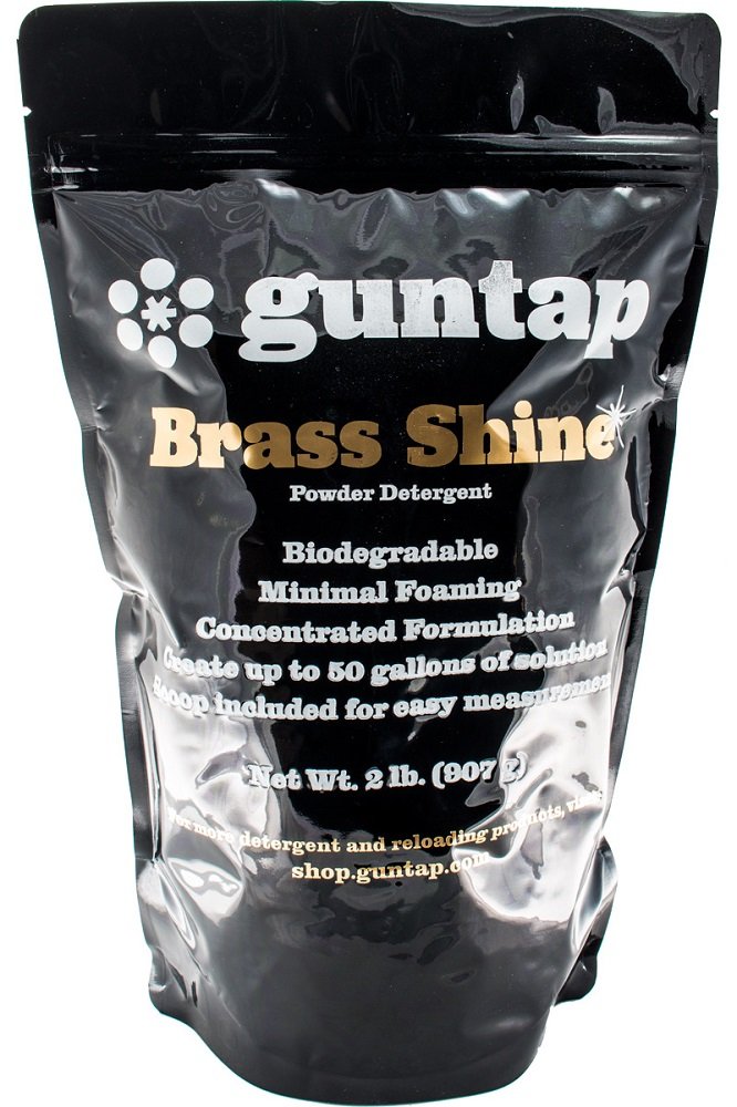

                I use this stuff for detergent as an alternative to Dawn and LemiShine. It's pricey but it is low-foaming and it works well https://www.amazon.com/gp/product/B0...?ie=UTF8&psc=1
                I always use cold tap water with great results every time so far.
