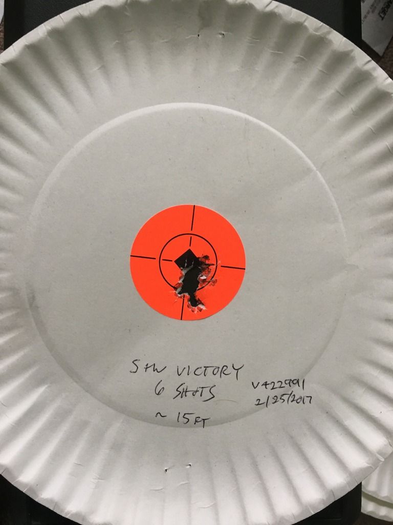

      I don't own and have never used a powder measure. I started out weighing every powder charge when I started handloading in the 1980s and that's the way I still do it. For me, the goal is not just to make ammo, but to make good ammo, better than the mass-produced ammo you buy in stores. By weighing every powder charge I can make very consistent ammo.
      It is very satisfying to take an old World War II S&W Victory revolver with its rudimentary sights and shoot like this standing (no support)
      with ammo that I hand-crafted for consistency.
      Because I don't use a powder measure I don't have to worry about how well a particular powder that I want to use flows through a powder measure and how consistent the charges are, and my workflow makes it very unlikely I will double-charge a case.
