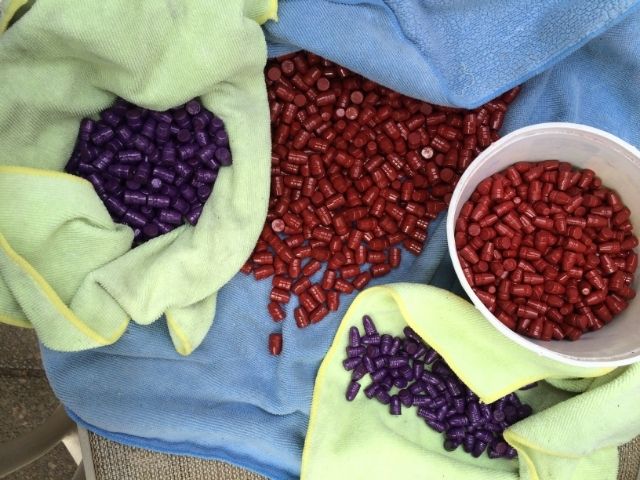

                      I love powder coated bullets for my handguns, except I powder coat my own cast bullets
                        CGT80
                        • Jul 2008
                        • 2981
                        yep, my skittles boolits above are my own powder coated boolits from NOE 5 cav aluminum molds. Tonight I was working on building a new 100 pound capacity lead casting post. The lee 20 pound empties out too fast.
                        Some people worried about the coatings being abrasive, but extensive testing from castboolits members shows that the gloss powder coating has not worn their barrels any noticeable amount over 10's of thousands of rounds. There is concern over matte powder coat.
                        Coated bullets, even commercial moly coated, beat the heck out of was lube as my guns stay much cleaner and there is far less smoke. That becomes a problem if you run a big competition or class and run 500-800 rounds through a gun in a day.
