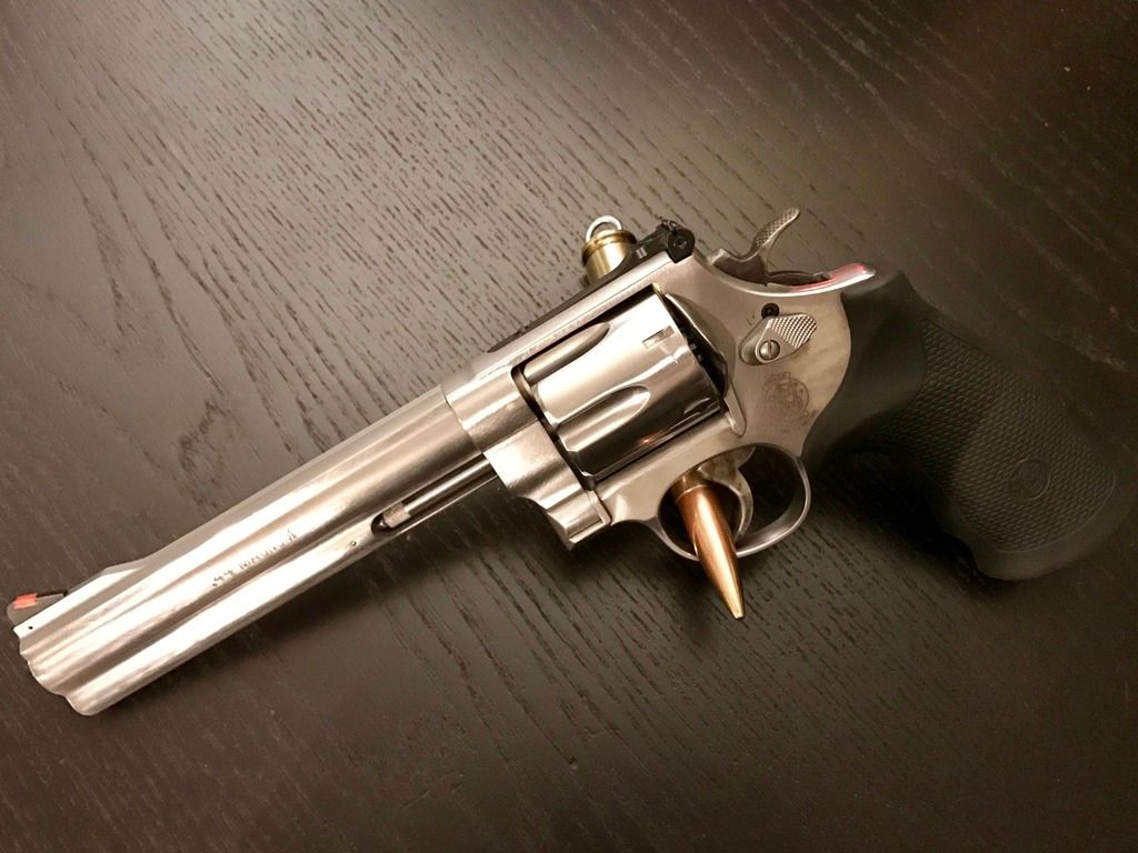

                Thanks all for the very useful information! I'm currently using HP38 on all my loads recently getting into reloading. I load 9mm, 38spl/357mag, .45acp and now .44mag. I'll definitely look into the other powders recommended H-110, 2400 and HS-6.
                My .44mag is a S&W 629 Classic in 6 1/2".
                Shooting it for the first time yesterday. Love this gun!
