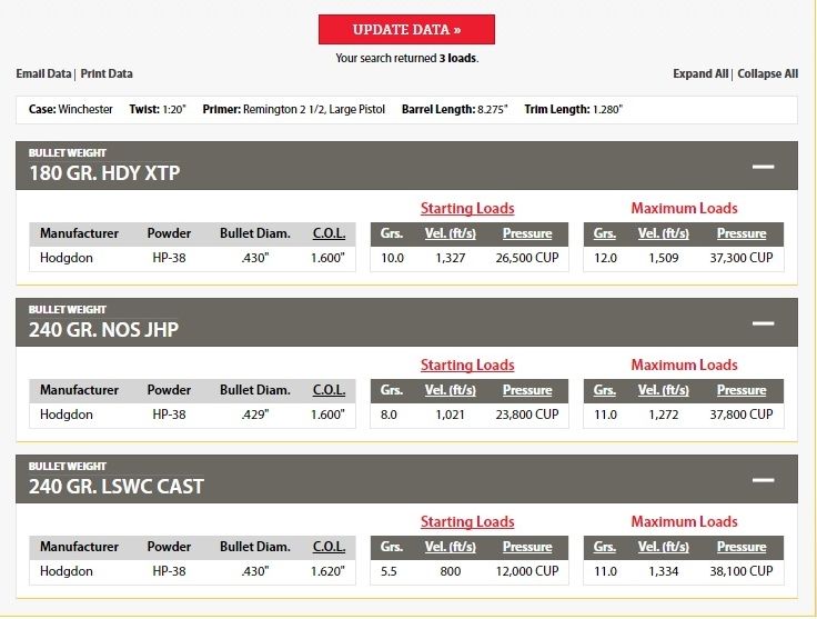

    Hey Fellow Loaders,
    I had a question on 44mag loads. Looking at Hodgdon's load data the min/max range is quiet broad with a 2-3gr difference for 180/240gr bullets. I normally start at min and work up to where I like. I currently don't have a chrono. Wondering what some of you are loading at for these bullet gr.
    Thanks!

    I don't even consider approaching max loads with HP-38 or any other fast powder with the 44, as that's not the best powder for that.
    I only use the faster powders for practice loads near the starting load range that's fine. I would use a powder more in the Unique range.
    Red Dot is a decent powder for cast or Trail Boss works very well.
    Generally I stay with coated lead bullets at 240gr, and for max loads I would use H-110, 4227 or 2400.

                Thanks all for the very useful information! I'm currently using HP38 on all my loads recently getting into reloading. I load 9mm, 38spl/357mag, .45acp and now .44mag. I'll definitely look into the other powders recommended H-110, 2400 and HS-6.
