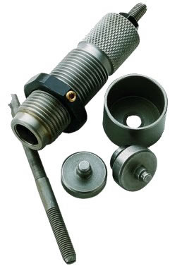

    The primer pockets need to be swagged. They have reamers but for me they only work about 70% of the time. RCBS makes a set that goes in a single stage press and it works great. I'll try to find a link for it. Here is a good picture of it.
    RCBS 9495 Primer Pocket Swager Combo RCBS Bullet Casting Tools/Accessories Melting lead and casting lead objects along with lubricants for bullets are the primary functions of these tools and accessor
    It works great and it goes pretty quick once you figure out the best way to do it.

        RCBS Rock Chucker
        Hey, this looks good, nice price also. I have a RCBS Rock Chucker, guess it will work with no problem? Thanks for the info.
        or this one? what the diffreance?
          http://www.midwayusa.com/eproductpag...eitemid=447022
          Same thing. I posted the other link because it had a better picture. It should work perfect with your Rock Chucker.
