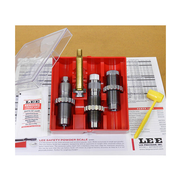

              Lee 223 Pacesetter 3-Die Set includes Full Length Sizing Die, Easy Adjust Dead Length Bullet Seating Die, Factory Crimp Die, Universal Shell Holder, Powder Dipper and Instructions/Load Data. This die set may be used to load 5.56 NATO (5.56 x 45mm) brass. You must follow load data published for the 5.56 NATO, available
              Graf & Sons, the reloading authority, has a wide selection of reloading supplies, shooting supplies, ammo and more.

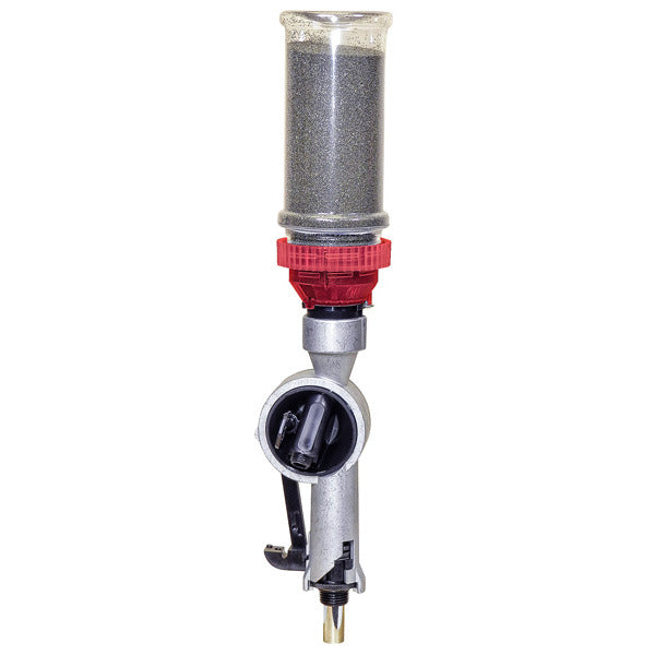

              New for 2020, now includes Powder Measure Bottle Adapter Automatic case actuated drum powder measure. Accurately and automatically dispense powder in your favorite cartridge. Two infinitely adjustable drums included. These Quick Change drums will accurately and reliably drop charges from 1 to 80 grains of powder. Case
              With those three items, you'll be loading .223 accurately and quickly. All in stock. I ordered a metric crapton of equipment from Grafs, all in one single order, and it arrived promptly, packaged perfectly, and not a thing missing or broken. Grafs is a great company to order from.

                Thanks , I ordered the LEE 90194 .
                I don't know how I missed it in Lee catalogs .
                I have been using my 25 ACP for the 270 .
                It looks like the LEE 90194 will work for the 270 ,
                30 carbine and 30/30 . If it does , I will get 3 or 4
                more [ birthday coming up in August ]

                  My pleasure, anything to help. I use that exact die to charge .223 and .308, it works perfectly for both. How are you going to drop powder?
                    tonyjr
                    • Nov 2015
                    • 1448
                    I have 2 of Lee's . I probably should get another . It is getting better - I have 6 nephews and 2 nieces that come here to reload . Most of time we only do 2 calibers , so I set up before they get here . Lately the nieces have been wanting to shoot the 9 mm and 45's as opposed to the 25 and 380 .
                    2 nephews have been shooting my 50 AE and 44 mag . Before it was the 45 and 357 [ theirs ] Last week 4 of them showed up and found out how much work it is - changing the LEE POWDER MEASURE , plates , looking up powder charge , setting up dies . I probably have the tumbler running 6-7 hours a week . I deprime and prime by hand .
