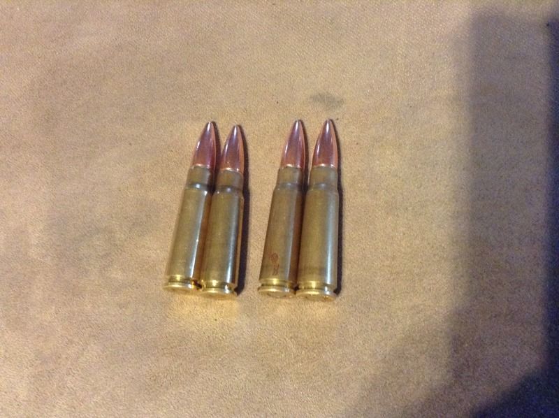

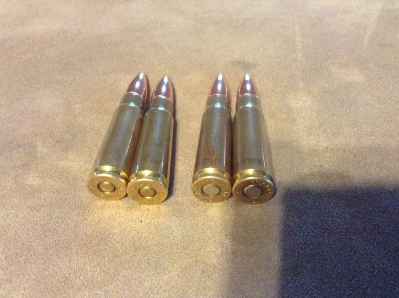

    I know most of you guys are pro's but this was my first run.
    123 gr barnes triple shocks lead free
    30 grains H335
    2x Remington small primer brass/Remington 7 1/2's
    2x Bulgarian large primer brass/WLR's
    2.190 oal
    Crimped at last cannelure(sp)

    Primer depth looks good, COAL looks consistent, clean, no bulges, great powder. Please pay all postage and send a couple hundred of same to me for further evaluation.

      Looks good , I'm no pro but I would suggest starting with a ladder work up and find the exact powder charge that works best in your gun.
          Trying to slowly get to that point. I only made a few to find out if the low charge will cycle my bolt. I have had an issue with a tight chamber on one round, maybe from the crimp. I used the larger expander(wasn't paying attention) on the first 4, but will go with the .308 expander and no crimp in the next batch.
