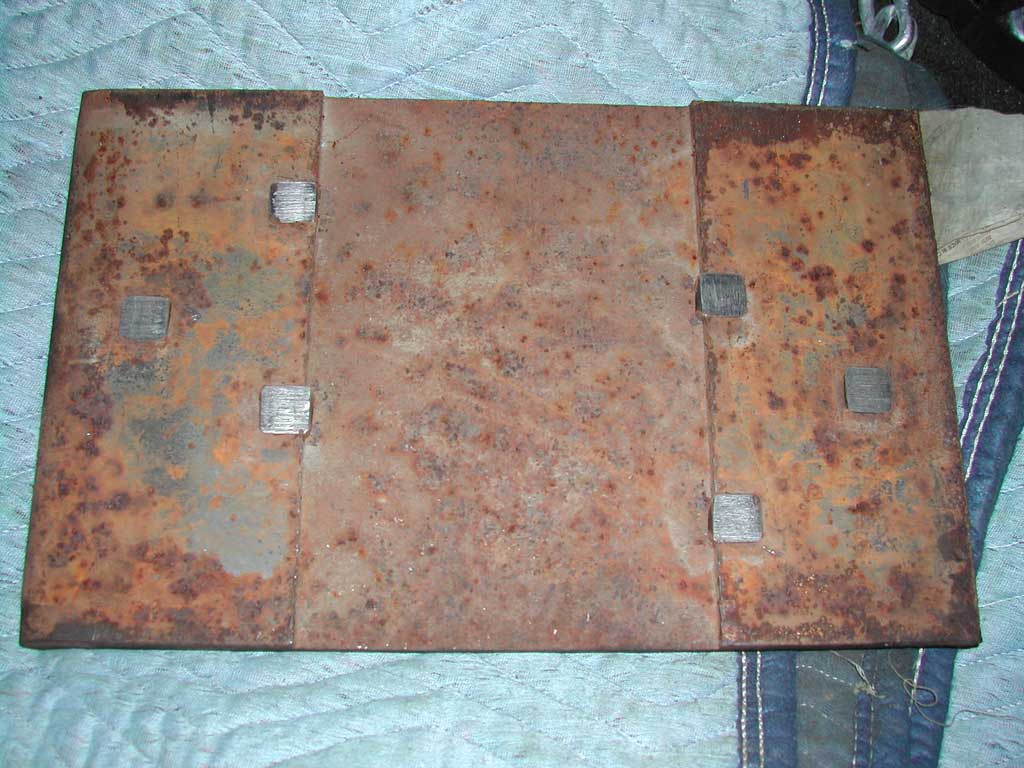

            • #21
              ar15barrels
              • 57181
              Originally posted by Timberwolf
              I'm a little annal as I'm not just satisfied hitting that steel plate at 400 yards, I'm not satisfied unless I hit the bolt holding the steel plate.
              Stay away from our new steel at the spot.
              Ryan already shot one of the bolts.
              I have a solution though...
              All the holes are getting plugged and I'm welding chain to the back of the plate.
