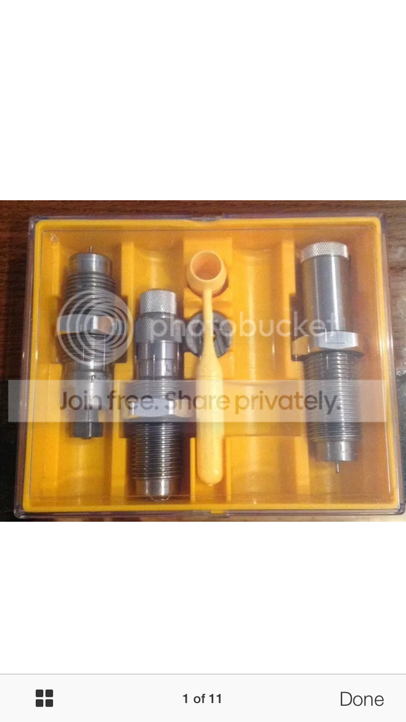

            I'm using the neck die from the 3 dies deluxe kit(yellow box), which I believe is the collet die. The first time I put a case in, it was so hard it almost got stuck. So I oiled the die and it got a little better.
            After I noticed this, I used the FL die a couple times to check how hard it would be, and to my surprise it was so much easier. The neck die just takes way more strength and it almost sounds kinda rough.
            im using the die on the left, it is marked 308.
            maybe something wrong with die? Like I said I bought it used, but I blew it out with compressed air before use. Any way to check for possible obstruction inside? I shined a light in but couldn't see anything, (plus I wouldn't know what to look for) I'll ask my friend how to take it apart when I get home.

                    Ok..hold it..The Lee "delux set" (what you have called it and shown the picture of) must come with a full length sizing/decapping die..a Collet neck size/decapping die and a bullet seating die...if you are thinking you are "neck sizing with the die on the left as we look at the picture that is not right...The die on the left side as you look at the picture is a standard full length die with a decapping pin...that is not a collet neck sizing die...the die on the right of the picture with the flat nurled knob on top is a collet die...I'm not sure what comes with what kit but if you got this from someone second hand you may have a bunch of mixed up dies....I'd strongly suggest looking at the lee videos on their web site..if you tried to size the shell "dry" with the die on the left side of the picture looking at it you were trying to full size the brass with no lube....no wonder it was tough and it's lucky you didn't stick the case...I also notice you said somewehre you used gun oil to lube the case...gun oil is not good for lubing cases...I think you need some loading books and possibly a class before you take off at a gallop and get in a real jam...not being an old grouch but learning to load on the internet is not really the safest thing to do..an NRA loading class or a class from one of the LGS that sells supplies, etd (like La Mesa Collectables...I think they have classes) might be of some help.

                        Sorry but he specifically said he'd been trying to 'neck size" with the die on the left of his picture...that is not a collet die...the collet die is the flat top on on the right side...
                        I've not seen a 3 die set like this...it may be an out of date set...the Collet sets I have and I have several...come with only 2 dies...the collet/decap die and the bullet seater along with a shell holder and dipper....I have never seen a true Lee die set with the make up shown in the picture..(a full length sizing die, a collet die and a bullet seater die...but I know if you try to size without lube in a full length die it's a near impossible task..much like the o/p has described....we need to get this straight with him as far (for sure) what dies he's trying to use to neck size....
                        Here is a amateur video about a comparison (side by side) of a full length sizing die and a collet neck sizing die...the video can be confusing because he doesn't get the die identification mentioned till into the video...and this is simply a conventient way to show the 2 dies side by side but you wouln't use them in that manner...the die on the right as you look at the video is the collet neck sizing die and the die with the nut and pin end on top that is inthe left side of the video is a full length sizing and decapping die
                        Both dies will decap the fired primer but one die only does the neck sizing and the other full length sizes back to original SAMMI specs...

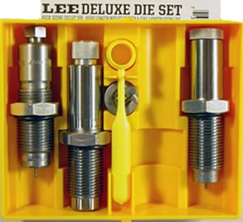

                          Yeah I'm an idiot I mixed up those two dies. Here's a pic of the exact set I have.
                          So do I have a neck sizing die here or what? This explains why it one was so damn hard and the other was so easy. Fck this is embarrassing.

                            What you have in the picture you have shown here is on the left a full length sizing/decapping die...see the nut at the top of the die and the pin sticking down through the bottom? That is what a full length die looks like...the die in the middle is a bullet seating die...the die on the right with the nurled flat nut on top and the pin sticking out of the bottom is a collet/decapping die...it neck sizes and knocks out the spent primer.....I might suggest you look at the Lee videos and also some videos by ammosmith.com ... his are about the best and it covers all sorts of tools and loading...I think you might have just gotten in a hurry and tried to start to prep your brass and got mixed up...now to further complicate things...there is a die that lee makes called a universal decapping die...it looks like the full length resizing die but the inside is just a bit hole with the decapping pin running down through it...it's used to just decap without doing any sizing (full or neck sizing...either one)...it's handy for decapping spent primers befoe you clean the brass so you can get the primer hole cleaned while cleaning the brass...then you have to size the shell (either full length or neck size).
                            You need to determine what you want to do and then get the proper tool installed in your press and learn the proper procedure for doing your task...it's awfully easy to mix things up and just start grabbing things...they sort of look alike...you will get it...there are copies of the instructions for all Lee's dies on the internet pdf format if you don't have the instructions...might be of help...

                              From left to right you have,
                              FL sizing die,
                              Bullet Seating die,
                              Empty space (on a 4 die set it would be a crimping die)
                              Neck Sizing die.
                              We all had to start somewhere, asking questions is a good thing. The resources here on Cal-Guns are incredible. I would use case lube with the FL sizer not gun oil.
